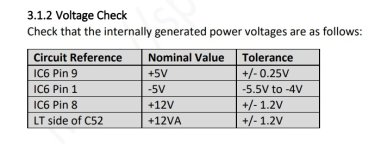

>>> So far I think the voltages look good.
Why ‘think’ when you can check the data sheets?
The 4116 DRAM data sheets state that the power supply rails have a 10% tolerance.
For the +/- 5V rails, this equates to +/- 0.5V (therefore from +/- 4.5 V to +/- 5.5 V is acceptable).
Therefore, your unloaded reading of -4.31 V for the -5 V rail is too low.
However, the +5 V rail feeds logic chips that generally have a +/- 5% tolerance, so the +5V rail should be between +4.75 V and +5.25 V.
How are you measuring these voltages out of interest? If you are using a multimeter, this may not be telling you the truth. The DC voltage should be within the stated tolerance band, but the AC noise (as measured on an oscilloscope) should also indicate that the noise is not excessive either. High frequency ‘noise’ will cause a multimeter to ‘misread’.
The -5 V rail on Sinclair machines is notoriously troublesome, so should be investigated carefully.
This supply rail drives the DRAM, so could cause misreads/miswrites by the CPU or (if it fails) damage the DRAM.

I've been told that some of the documents that I've been working with have errors, so there has been some guesswork trying to reverse engineer the new board from the malfunctioning original. Still, from what I can tell, I seem to be on the right track. I just need to figure out what's pulling the -5v line low.

The attached panel from the Spectrum service manual may be of interest: It shows that the design spec of the -5V rail actually has quite a wide design tolerance, certainly wider than that suggested in the RAM datasheet.
The DC-DC Converter circuit seems to have evolved quite a bit through the various issues. There is a section in the service manual, link below, page 48, dedicated to the modification of the DC-DC Converter - this section is original Sinclair text but there is a red warning not to actually attempt the mods detailed in that section (...scratching my head).
