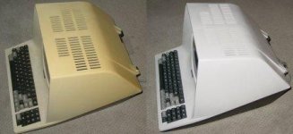

This was my best result to date.
A Televideo 910, that was supposed to look like this, but didn't:

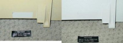

The label removed from the back side of the terminal shows what I had to deal with. This amount of yellowing on the backside and top, indicates that this Telvideo probably spent it's life backed up to a window.
This one took 5 batches of the paste/gel solution = 10 applications (washed off between every two applications). The solution was on the parts for about 2 1/2 hours at a time, after which I either reapplied it, or washed it off, and started again with another application. Total time of processing under UV light was approximately a day.
Here's the result:
This one was processed using, and needing patience (in short supply here - but apparently that's what works). I also used the Kelzan Xanthan Gum this time, and it was the first time I'd had the opportunity to use it. It makes a very nice paste/gel, easy to work with (spread around and still sticks to verticals), and I suspect it had something to do with the results.
I am really chuffed with the results on this one.
