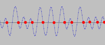

Here's a link. The data is based on timing the waveform crossing positive to negative. That triggers an interrupt.
Negative to positive transitions are ignored.
Short duration between two triggers is zero, long duration is 1.
Link: https://wav-prg.sourceforge.io/tape.html
If the signal is inverted, the bit timing will be incorrect.

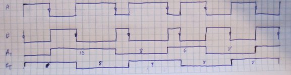

Although I know from building my own computer that the data cassette won't work if the signal polarities are wrong, it has been a while since I built my PET 2001 clone and the cassette interface and I still can't find that technical bulletin I mentioned, but just to reassure myself that I am not going mad I quickly put pen to paper.
The Commodore encoding scheme measures the time interval between high-to-low edges (or it could be the other way around as far as I can recall - doesn't necessarily matter). This timing information does not necessarily remain the same but simply shifted in time if the signal is inverted. I just drew waveform A and its inverse B. At and Bt are the timing intervals between high-to-low edges of waveforms A and B respectively. I'm not saying that this is an accurate representation of the PET data stream (I'll have to find that bulletin) but it's enough to demonstrate the principle.

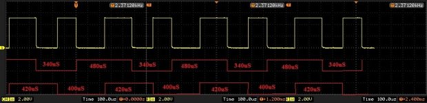

Well, my guess on graph paper wasn't too far off the mark!
I've just come back in from the shack, having fired up the PET 2001 to capture some data cassette serial data. You mentioned the SOL. If its data cassette is not polarity sensitive and it is not return to zero (like, say the TRS-80), then my guess is that is uses frequency shift keying modulation.
This is not what Commodore does. The PET uses fixed frequency duty cycle modulation - See the timing diagram attached, which I produced from the captured data on my DSO. The PET uses a fixed frequency of approx 2400 Hz and it is the duty cycle of each pulse, not the period as per FSK, which determines if 0 or a 1 is being represented. The PET doesn't do the 0 Vs 1 cycle timing perfectly - it alternates between approx 400uS and 420uS per cycle, depending on if a 0 or a 1 is being represented, but this is not how the information is conveyed.
It is the time interval between high-to-low (negative-going) edges, which selects either a 0 or a 1. I don't know which way around it is, but one is represented by an interval of 340uS and the other by 480uS. If you invert the signal and trigger off the positive-going edges instead, then the information content is lost!
