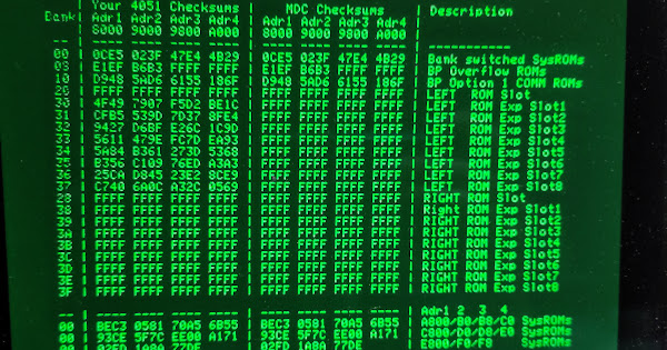

Things are looking pretty good on both 4051s. ROM tests report correct checksums, as you can see here in the "working" machine:
You can see that the MaxiROM cartridge is fitted. It's also apparent that there is an issue with the screen not storing well in the upper right-hand corner, which must mean more calibration in my future.
The "working" machine has 32K of RAM fitted. The RAM test program on this machine prints 7FFF at top left of the screen, which I assume is the memory size. It then appears to do fairly little, very occasionally clicking the speaker and toggling the state of the BUSY, BREAK, and I/O lamps. This goes on for a few minutes after which the machine beeps and appears to reset itself (or to exhibit the same behaviour as executing DEL ALL). I assume that no news is good news in this case.
On the (formerly?) "broken" machine, which has only 24K of RAM fitted, the behaviour is the same except the machine prints 5FFF at top left. This is consistent.

Happy to see you like my 4051 checksum program output on a single screen showing up to two 4050E01 ROM Expanders with sixteen option ROM Packs!
