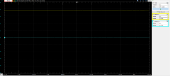

Here is what I have for pin PP with the ribbon cables installed between the front panel:

If I recall correctly reversing the cable gives all LED on. Since there isn’t power in the cable it isn’t that dangerous.
Ok so PP is always 0. That could explain why you have all LEDs off. What a out the clock signal at pin CC and the 74193 counters? Is there a clock and are the two 74193 counting correctly?
Looks like you are correct. All LEDs, including the RUN LED illuminate when I reverse the cable.
Nothing on pin CC, though. Here is what I found on the 74193s, known as E6 and E8:
Clock input (pin 5) on E6:
Clock input (pin 5) on E8:

Ok. Then the problem is not the display. You need to get a board extender to raise the control board so that you can probe it. Douglas Electronis used to have suitable modern extender boards. I am not sure if still is the case.

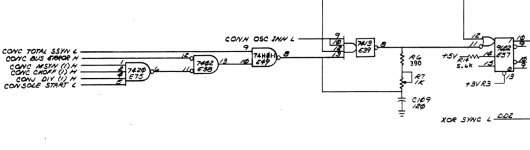

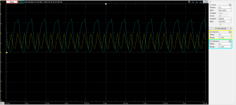

I took a look at the CONJ print today. If I'm reading it correctly the clock outputs come from 74H40 ICs E10, E64, and E84. I took the same exact measurements on all 3. Ch1 is on pin 6 (Clock L), and Ch2 is on pin 8 (Clock H):
MattisLind
Sep 30, 2013
1,006
Stockholm, Sweden
Looks like there i no clock. Now you need to figure out why.. First I think that you should check on the oscillator itself. At E39:8.
Then if there is nothing here there are multiple signals that could turn off the clock.
Check all those and see if anyone has a level that blocks the clock generation. If not then the problem is E39 itself. Otherwise you have to follow the signals upstream to understand what is going on. As an example for why the clock is stopped is that the CPU is waiting for a Unibus transaction to complete. An MSYN has been issued and it is waiting for a SSYN.

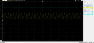

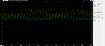

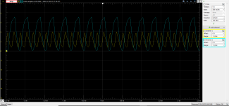

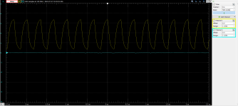

It had occurred to me that my scope was having a grounding issue and I wasn't getting the best measurements. I fixed the issue and retook said measurements of the circuit shown on 'CONJ':
Starting with E75, pin 1,2,5 had no signal on them. Pin 4 (CH1) and Pin 6(CH2) did:
E38, showing inputs on Pin 11(CH1) and Pin 12(CH2):
E49, Pin 9(CH1), and Pin 10(CH2):
l
E39, Pin 8(CH1):
E57, I got the same measurements on Pins 11 and 12 as Pin 8 on E39.
E65, I have to go back and take a look at that one, I neglected to take notes on it...
E64, P1(CH1) P2(CH2):
E64, P4,5(CH1) P6(CH2)
E64 P8(CH1)
E84, P1(CH1) P6(CH2)
E84 P8(CH1)

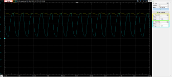

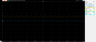

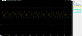

Per request, here are the readings on a 500 ns/div scale:
E75- Nothing on pins 1,2, and 5. Here's what was on pin 4:
and on pin 6:
E38- pin 11 on CH1; pin 12 on CH2; nothing on pin 13 out:
E49- pin 9 on CH1; pin 10 on CH2:E49P9,10.PNG
pin 8:
E57- pin 11 on CH1; pin 12 on CH2:
pin 10:
E65- pin 1 on CH1; pin 2 on CH2:
pin 3 on CH1; pin 12 on CH2:

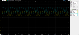

Right. Then there are clocks! check the signals on E10, E64 and E84. What is the state of CK OFF signal?
In my experience 7440 buffers are prone to fail.
Just curious, what is the bandwidth of your scope?
wh3016
Jul 20, 2022
50
Massachusetts

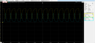

I'm using an Analog Discovery 2, by Digilent. 30MHz bandwidth. Here is what I found on E10, E64, and E84:
E10- Pin 1,2,4,5 on CH1, Pin 9,10,12,13 on CH2: (1,2,4,5 are shown tied together, as well as 9,10,12,13)
Pin 6 on CH1 and Pin 8 on CH2:

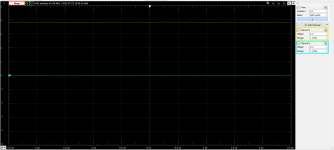

E84- Pin 1 on CH1 and pins 2,4,5 are tied together on Ch2:
Pin 6 on CH1 and pin 8 on CH2:
E64- Pin 1 on CH1 and 2 on CH2:

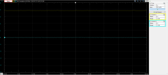

Pin 4/5 (CONC CKOFF L) on CH1 vs. E75 pin 2 on CH2 (CONC CKOFF H):
Last but not least, pin 6 on CH1 and 8 on CH2:
So there are clocks? I honestly expected to see a more square wave than what was seen. Might have to see if my probes are compensated properly. before the last post, I had an 'a-ha' moment when I realised that I had both probes on the 10x setting and not the 1x.
