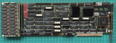

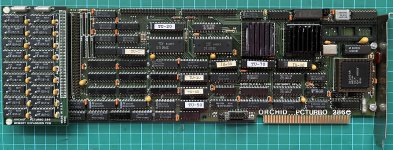

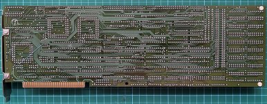

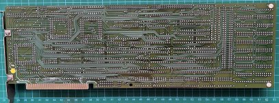

I have two non-working PCturbo accelerator boards that I’ve been trying to revive. These boards are particularly interesting as they do not use a cable to connect to the CPU socket but are instead able to control the 8088 and use it for I/O. On startup the PCturbo board holds the 286 in reset. You then need to run a driver program called “turbo.com” that sets up a shared memory location (default E000h) and copies across to the board an 8K bios image embedded in its .com file. It then takes the 286 out of reset and at this point execution switches to the board and you now running on the 286.
I’ve been building on this initial work of @per and have setup a Github repository (https://github.com/retrobyte83/pcturbo) where I now have a reasonably complete disassembly of turbo.com and a partial disassembly of the bios code, made using IDA. I also have a partial schematic from buzzing out most of the key traces, including everything that goes to the two 40-pin extension headers (address lines, data lines etc).
Board 1
This is the board I first talked about here. When I got it, I found that the 286 had been installed in the wrong orientation. I’ve subsequently tested the CPU in another machine and it is fine. I’ve also debugged the startup to the point where the bios has been copied across to the PCturbo and the CPU starts running on the board, but after a bit it halts and the turbo.com driver errors out with “PCturbo not responding”.
Board 2
This board I got recently from @Mike1978 . It was DOA when he first got it, and having done some testing myself I can confirm there are no signs of life. The turbo.com driver errors out with “Cannot access the PCturbo”, which is what it would do if no board was installed.
My hope (with some help!) is to try and use the different behaviour of both boards to progress the troubleshooting. My focus is currently on board 2, since it doesn’t seem to even get anywhere. I’m hoping if I can fix this initial issue, maybe it will spring into life or at least it might give me some direction on board 1. Given they behave differently, I’ve extracted a minimal code path from turbo.com into a small test executable “turbochk.com” which runs to the point where the behaviour diverges. It does some initialisation and then tests writing and reading back some bytes at the start of E000h. On Board 2 this check fails, but on board 1 it succeeds (and would start to copy across the bios beyond this point).

Ok, there have been some developments!
I’m still working on tracing the ISA bus through the card (progress so far attached). As you suggested Per, it looks like it will end at the gate array after passing through some of the “TU-“ PAL chips.
However, while buzzing out the non-working board I’ve found that the IRQ 5 line is shorted to ground, and it definitely isn’t on the “working” board. There is no obvious trace damage, but it’s a multi-layer board and for a time it seems like that trace is running on a middle layer somewhere. Ultimately it goes to the D71059C, so perhaps that is shorting internally.
I’ve ordered a replacement but it will be a few days before it arrives. I think in either scenario I’m going to have to desolder it, and at least see if that clears the short.

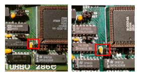

I've desoldered the Interrupt Controller from Board 2 but unfortunately the short remains, so somewhere the IRQ5 line and ground must still be touching. Closer inspection of the exact tracing has definitely yielded something interesting though.
-The IRQ5 line runs from the ISA connector to a via (points A to B in attachment 1).
-The via is then connected to the lower pin (C) of the “5” jumper of the IRQ jumper block in attachment 2. This pin is then connected to the right-most pin of jumper block J1 (D).
-In attachment 3, the pin to the left (E) is connected to another via (F), I think through a mid-layer as I can’t see any obvious trace. Then finally a trace runs from the via to pin 23 of the interrupt controller (G).
The most suspicious part is the trace between points C and D in attachment 2, as it runs incredibly close to a via that I’ve circled in attachment 4. Buzzing it out shows that via is connected to IRQ5 and ground.
Checking the Board 1 yields a bit of a surprise, that via has been completely removed and the trace is severed! Basically, there is a hole in the board (attachment 5), and then a patch wire on the back (attachment 6) linking the two jumper blockers (points C and D)
This is all pretty strange, was there a manufacturing defect on some of the boards? One of these boards has the fix and the other doesn’t?

I had wondered if these bodge wires may have at some stage come away for some of these cards.. they will have had an interesting life since the time they were made. This one crossed the pond at least once!

Per - That via only sits on the IRQ5 path. I agree the board should in theory work fine using IRQ7. In fact I've removed all the IRQ related jumpers and my test program still works fine on the first board, so I know this is not the main issue.

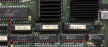

Anyway, here are the photos. Hope they are clear enough. Board1 is not working. it always hangs when the driver is loaded. Board2 works, and has a 80287 Math-co. I am curious if there may be a RAM issue. I think i will swap RAM boards to test further. These MT DRAM chips are used on the Commodore 8-bits from time to time and are notorious for failure. Thoughts?
Just want to add to my previous message...a little more troubleshooting on my end... My working card, usually on the first boot (and a few subsequent) will restart the machine as soon as the DISK CACHE is executed. I wonder if this is just a bug, as I believe it uses all of the native RAM for caching in TURBO mode. Because it does eventually run. When I do a memory test using CHECKIT while the turbo is running all RAM checks out. Also I don't believe me swapping RAM boards between units is a good idea. The extension only accounts for half the RAM.
Many thanks for the pictures - very interesting.
Your boards seem to be a slightly later revision, with the 286 in a plcc package, and one of the pals seems to have an update (labelled TU-21 vs TU-20 on my boards).
Also, that pesky via is now gone! Pretty clear that was a factory issue on the earlier ones.
