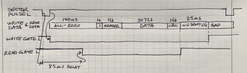

Do the DEC controllers rewrite the sector header when they write a sector?
Yes, and thanks for asking. I need to replicate the controller signals to test the emulator. The RK8E controller writes from the trailing edge of the sector pulse up to a tiny gap prior to the next sector pulse. Refer to the WRITE GATE L waveform below.

And the RK05 and RK8E do the same. There is a splice immediately following the trailing edge of the sector pulse at the beginning of the all-zeroes data. However, when reading, the read gate is asserted about 83 μs after the sector pulse (85 μs read gate delay minus 2 μs sector pulse width), so while reading, this splice at the beginning of the sector is never seen by the controller.
This timing diagram is how it works. Note that the controller doesn't simultaneously assert Write Gate and Read Gate. They're shown on the same timeline for comparison.
The attached pdf shows how the signals are created in the RK8E controller and there's also a copy of a DEC document page that documents this timing. It helped me to understand the schematic first though, to know what they intended in this diagram.

thank you! as you know from looking at the documents, this is all clear as mud in them.
