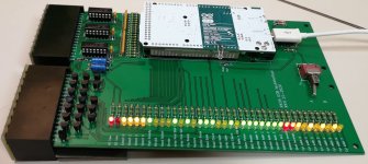

I knew these drives were coming to me and I wanted to have a simple test interface.
DEC had the RK05 exerciser but these are probably impossible to find. So I've drawn a PCB to
interface with the disk. The test routines are described in the RK05 exerciser documentation.
The idea is to put an Arduino Due on the board and plug it into the drive. Or use an Unibus cable and
two H851 blocks. Then you could use the board outside the drive. Maybe it is even possible
to read or write disk images at a later moment. We will see how things will go...

I have built my RK05 test interface and currently writing software for it.
Until so far it is doing what I want...

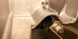

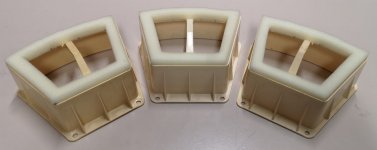

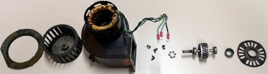

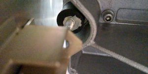

So I've spent a few hours on the drives. These were once spare part drives and there were no intentions to use them ever again.
All the foam was in bad shape off course. So I made new sealing foam for all the drives.

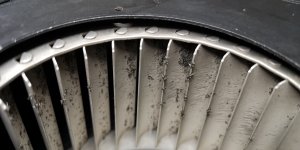

In one drive the fan has eaten the foam and put it all in the air filter...
All washable parts were cleaned thoroughly, but I got some new parts too.
One air filter was really dirty with a black greasy dirt. That filter is replaced.
I've replaced the bearings in all except one fan. These were too noisy...

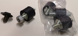

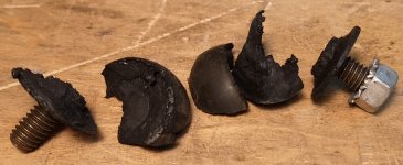

One of the rubber dampers fell apart. So I had to search for a replacement.
Finding the right size was one thing, but the right hardness was another problem.
I think my new damper is a bit too hard, but I cant find any other model...
11 broken damper.jpg 12 broken damper.jpg 13 new dampers.jpg 14 new damper placed.jpg
