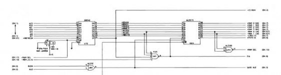

Two things:
1) In order to get true 0-wait, I think you are going to need to assert MEMCS16# before the lower 20 bits of address are on the bus. I.e. before the rising edge of BALE
2) CEH = MEMSEL & BHE;
I don't think this is going to work. The system board holds SBHE# low when doing a word transfer.
If I were you, I would just ignore the SBHE# signal. Your card is not intended to be backwards compatible with 8-bit buses nor does it have any steering logic to put the high byte on the lower data bus, so I don't see why you'd need it as long as you assert MEMCS16# appropriately.

1) Well that's unfortunate... So it seems zero wait states might not be possible for this board then. Asserting MEMCS16# based on a decode of LA17-LA23 like the 5170 technical manual suggests wouldn't work as that only gives us 256k "chunks" of memory and in the UMB area that might clash with things like VGA BIOS ROMs that could be 8-bit. I was hoping some of the references I can find online that seem to suggest MEMCS16# is samples after BALE goes high were correct (here for example)
2) I'm getting conflicting info on the polarity of BHE. The technical manual and HwB agree that it is active high, but other sites like here say it is SBHE#... I'll take your word for it and fix that in the GAL code ;)
As for ignoring it entirely, that makes sense for reads, but are all writes guaranteed to be 16 bit?

First let me say I'm no expert, I've just only designed my first ISA card recently (documented here: http://www.vcfed.org/forum/showthread.php?71494-Designing-a-16-bit-ROM-card/
I think different chipsets sample MEMCS16# differently. I'm still trying to figure that out myself.
As for SBHE#, it is definitely active low. I believe that all writes will in fact be 16-bit if MEMCS16# is properly asserted. We had better hope so, because if the system does a split transfer to an odd address, it's going to write to D[7:0] so you're screwed anyway

This is interesting. Looks like IBM's "official" memory expansion board controls the data buffers in the same way - low bits controlled by A0 low and high bits controlled by BHE# low. They also derive MEMCS16# from a direct decode of the LA23-LA17 lines, so that doesn't really help me on if it's possible to add SA19-SA15 into that equation and still meet timing to get 16-bit transfers. And at that rate, it's not yet clear to me if I'm making things better or worse by latching the LA lines as part of that equation.
Research shows that 0WS might not be worth pursuing as the timing requirements might be impossible to meet on an 8MHz AT no matter how fast the logic is. I'll leave the jumper in there anyway and see how things go.
Looks like maybe even 1WS 16-bit transfers aren't possible on the AT/5170 unless using 128k blocks: https://en.wikipedia.org/wiki/Talk%3AIndustry_Standard_Architecture#8/16-bit_Incompatibilities
You can achieve 1 wait but not zero unless you decode LA and assert combinatorially within 1 CLK in combination with asserting ZWS# within 1 cycle of the strobe assertions.
BTW, your .oe logic is messed up in the CUPL file. For a single-side drive (high or low + Z), you should be setting the value of the FF to a 1 or 0 and assigning the non-Z logic to the .oe expression; not both.
In my revised ROM card design, I'm asserting MEMCS16# as soon as the 688 matches an address on SA[19:14] but both of my VLSI chipset based boards (one based on the VL82CPCAT-QC (VL82C10x chips) and the other the VL82CPCAT-16QC (VL82C20x chips)) still ignore it and split the transfer into 2 8-bit cycles.
I don't think it's propagation delay. The LS688 is rated at a max of 23ns and then it goes through 2 OC inverters (max 7ns per inverter). So only 37ns from the time that a matching address is on the bus to my card pulling MEMCS16# low, but these VLSI boards are still ignoring the assertion. I tried it on a 440BX for giggles and it works in 16-bit mode no problem

I'm afraid that my VLSI chipsets, being some of the earliest of their kind, are accurately emulating the 5170 system board's logic with respect to MEMCS16#. I'd love to get more opinions on this since I'm still trying to learn myself, but it sure seems like if you miss the first sample point for MEMCS16# (which appears to occur on one of the edges of BALE?) on these boards you don't get a second chance.
So this may shed some light on it. Looks like MEMCS16# is latched by ALE on the 5170 motherboard. The latched signal goes into a PAL which seems to be doing the data steering stuff. Sooo, it looks like one would have to beat ALE going back low in order to get 16-bit transfers. That would explain why the technical manual says to derive it from a direct decode of the LA lines.
