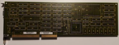

Hello,
a friend gave me this ISA card:
Peter Schranz suggested that it could be manufactured by ROI (Rolf Obler Industrieelektronik), but that company seems to have folded before the age of the Internet. He also mentioned that it might be possible that the serial port is likely to be wired as the DCJ11 console and the card could be made to boot into ODT by manipulating the jumpers correctly. JU02 connects to ISA interrupts, and changing JU01 does not cause anything to appear on the serial port, however. I tried two different terminals with all four jumper combinations, and I've sent a break with each of them to see whether that'd bring up ODT.
The card uses a lot of programmable logic parts - GALs, but also two interesting Am29CPL 154H Field-Programmable Controllers. To me, that seems to make reverse engineering pretty much a lost cause. I wonder whether anyone here has seen the board before or has other ideas how one could bring it back to life. Using it as a building block for a little PDP-11 based FORTH would be a fun exercise to me.
Thanks!
Hans

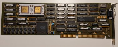

The Osprey/PC card has additional I/O connectors on the top an Altera FPGA for the glue logic, so it is different and probably much newer.

@Bitly Thanks for the pointer, I've written a note to the guy to see whether he had any success with the card. I've given it a closer look now and it seems to be a relatively straightforward ISA card with two I/O registers and a memory mapped segment into the PDP-11 RAM. If I manage to get it to run, I'll report here.
I'm a bit farther with analyzing the board, but what I've found does not make me optimistic that I can get it to run.
The card is designed as a coprocessor running in a PC running as the host. The host controls the J11 and presumably provides disk and other I/O services. When powering up the board in a passive ISA backplane, it sits idle with /INIT held low. /INIT is generated by one of the GALs, so it likely needs to be released by the host.
There are two 74ALS996 registers right above the ISA bus connector. They are readable and writeable from the ISA bus - Presumably, one of them is mapped as the Maintenance Register on the J11 side, but I'm certainly not sure. There are also three 74ALS996 paired with three cascaded 74HCT688 comparators on the upper right of the board. This apparently is a programmable 22 bit address comparator connected to the J11 bus. The J11 can write an address to the registers, and a signal is generated on the output of the comparators. Maybe this is some kind of hardware debug register, but how would I know?
There are no provisions for DMA to the ISA bus, so all I/O is controlled by the host. One of four 16bit IRQs can be selected using the JU02 jumpers.
I'll try finding the I/O address by putting the card into a PC, but I first have to set myself up with a suitable machine. In the end, however, the card is probably more of a curiosity due to its limited I/O capabilities (just the console) and dependence on a PC to run it. I might just rip out the CPU and build a system around it that is more fun.

very interesting! i don't think it's an Osprey, Strobe Data seem to be pretty good about marking their products from what i've seen. if you have an NT4/W2k machine you can install their software and see if it is detected, though. there is a hardware diagnostics script that you can use.
Osprey/PC is an interesting product. But, if you have to "Call for Pricing" then you cannot afford it.
i am sad to report that (at least according to my research) Strobe Data seem to have also folded some time ago. i am on an email thread with some of the folks that were there as i have a DCJ11 Osprey myself and they (apparently) do not function without a license- been trying to get that sorted, and also see if they are willing to open source their designs.
>>> I don't think it's an Osprey.
Correct. I was looking at the OPs photographs on my desktop machine (rather than my phone) and I could clearly see the "ROI" marking. I couldn't see that clearly on my phone...

I have found the I/O addresses now, but the PDP-11 memory does not seem to be mapped into any memory area between 640k and 1024k by default. The ODT debugger starts when the ISA bus is reset, so at least I know that the J11 is running. Even if I can figure out how to control the memory mapping, I will still need to have a host on the ISA bus that implements all of the I/O for the J11. As the bus mastering signals are not connected to the J11 board at all, it will always need to be hand-fed everything from the host, which kind of puts a limit on the time I want to spend trying to reverse engineer it.
