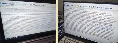

And I can say this now, since I've finally found a USB device that gets past that 460Kbps limit using RS-232. (more on that later)
First, let me show what I mean by "not supporting 921Kbps'. Image below is this initial setup..... USB/serial across two modern HP/Dell laptops (i5 and i7 systems).
Note the system is on the right has to use one of those USB-C to USB-A adapters.
Also note that in between the two USB/serial adapters is a null-modem adapter (invert tx/rx and cts/rts pins) and also a gender-changer. Noted because I realize that gender-changer alone could be a source of signal interference (especially when talking about 921Kbps speed), but it's all I had available at the time.
Next image is showing the "stability" of each of the characters, just casually typing them across a terminal. The system on the LEFT is able to receive these characters more reliably (not sure why). Each row is suppose to have the same character (just holding the key and going to next row for next key). In particular, the "d" "h" and "p" rows are pretty poor (lots of "misinterpretations"). But this is far better than the ~50% "stable" characters I had in my prior connection (different adapters).
So that's evidence that it is true - at these speed, shorter and more solid connection is essential. I would say with this setup the 921Kbps "casual-ASCII" data exchange was about 80% reliable (just look closely at the amount of incorrect characters per row, again the d/h/p rows especially). This was NOT reliable enough to attempt either a YModem or ZModem file transfer (error rate too high).
Someday I'd like to re-test without the gender change (requires a female/female null modem adapter, to then allow a straight through connection of the two USB/serial adapters).
Also note, I'm certain these aren't using +12/-12V swing. I don't have the means right now to put it on a scope - but the RS232 spec is "anything above 3V or below -3V" so this could be swinging at +/-5V (possibly even +/-3.3V).
However, see next message for a setup that did become reliable....

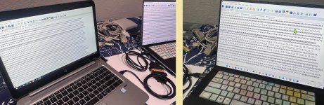

Clearing out an old closet, I stumbled across some old cables - which I thought were parallel port adapters. But I found a note inside them saying they are actually 25-pin null-modem serial adapters. Since they are BOTH null-modem, connecting them together as-is results in a "regular" cable. So I need to place a null-modem adapter in between them - which I understand isn't ideal, could be a source of noise/interference.
So using the same equipment and software (ZOC) as before, I hooked them up. (image below on the setup)
And to my surprise, there were no drop-out or mixed characters during my simple "casual-ASCII" keyboard test (while both connected at 921Kbps). Like in the prior setup, the d/h/p rows were very poor. In this second setup, everything went across perfectly.
So, what was the file transfer speed??? Next post...

With various other adapters, I could only get 460Kbps stable connection, and did achieve ~44KBps throughput file transfer as expected (using 8-N-1, so 10-bits per byte and plus whatever overhead of CRC checks and such that ZModem protocol has).
With these black 25-pin "mystery" USB/serial adapters, I can pair the two systems reliably at 921Kbps, but am only achieving a throughput rate of ~69 KBps. That's fine by me, a definite improvement over 460Kbps connection. However, I noticed when the laptop activates screen saver in a few minutes, the transfer generally gets error as I'm bringing the system back awake (which I can understand why, but just noting the multi-tasking effect on this "high-rate-for-RS232" type transfer).
Unfortunately, I don't have any recollection of where I got these USB/serial null-modem adapters from. And they aren't marked in any meaningful way (the plastic shell is just marked "RS-232"). I've checked order history and e-mails, and I can't find any reference to them. The closest guess I have is that they are something like this:
<https://www.amazon.com/Serial-Adapter-Converter-Communicate-Programming/dp/B07KYSQBKX>
(just noted as an example reference, various other places have this for cheaper)
EDIT: something in my mind thinks I got these from StarTech, but I still can't confirm where I got them. Not ready just yet to bust them open to see the exact chipset.
At least this does show that 921Kbps stable data-exchange is possible using the old RS-232 protocol. Again, I doubt these are using +/-12V. Maybe someday I'll put together an inline breakout box to try to scope on the pins, to help verify what voltage they are using.
Now as to why I'm only getting ~67 KBps instead of closer to the expected 90 KBps, I'm not so sure. Maybe it's a limitation of the FIFO buffer this device has (such as if 128 byte only?).
EDIT: According to the Windows driver for these USB/serial adapters, it is "Silicon Labs CP210x USB to UART Bridge" (and only has 16 byte TX/RX FIFO buffer). Another metric we don't really get insight into is the percentage of time CTS/RTS is being used (i.e. number of times it is signaled to "hold pls, buffer is full", which reduces throughput and suggest that a larger buffer might help).
