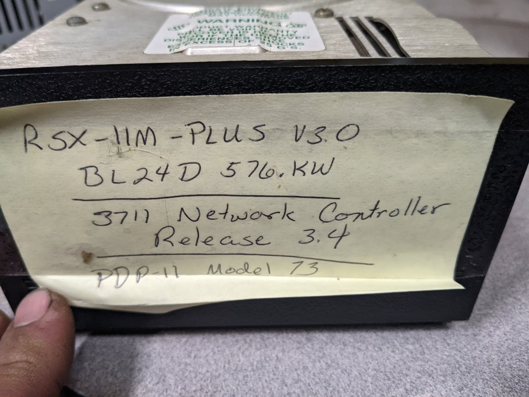

I'm going to resurrect an old thread, because I found this while googling RSX-11. There's a large post-it on the front of an ST-412 I just imaged:
Sadly, I don't check vcfed as often as I should, but if anyone wants the drive image, let me know. I have yet to figure out how to read it myself, but do have a PDP-11/73 I'll be keeping for myself.
