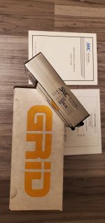

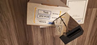

I have a GPIB interface for the Grid. It slides in to the battery port.
You'll have to rotate the 2nd one. I'll admit, opening the box was like opening Marcellus' briefcase in Pulp Fiction! :biggrin:A little mystical. :)

Could you post pics? Maybe it's possible to create one from off the shelf parts... :unsure:

Thats pretty cool! I wonder if that would allow me to communicate with my 7D20!

Just an update for anyone interested, I was able to get some basic communication using the Grid GPIB device from Shawnerz (thanks again) to a Tektronix 7D20 https://w140.com/tekwiki/wiki/7D20
(Much more powerful than a 222a) running in a 7623A!
I will be working on actually running some useful software to actually visualize and print the waveforms rather than just a data dump text printout of a flat line (shown here)
