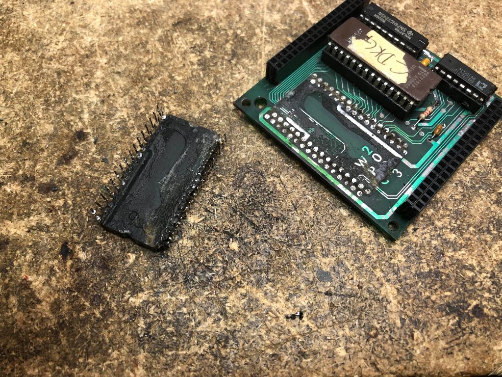

The first task was removing the module. This turned out to be far less pleasant than I expected. The solder on the module's pins were stubborn and heating up the pins would cause softened resin to be sucked into the holes. Ultimately the only solution was heat and more prying force than I was really wanting to apply. Eventually, the module came free, along with a half dozen traces...
The module was set aside and the board cleaned up. All the chips in the affected area were pulled, the board cleaned with hot air, a knife and acetone and new sockets were installed. Broken vias were patched and pulled traces were trimmed and new bodge wires run.
Now that the unit at least was probably in a working condition my attention went back to the module. The first order was to heat up some of the potting compound and start exploring. In short order, the window of an EPROM appeared, then the numbers from a Rockwell R6501Q microprocessor came into view. Quickly I considered my chances both sides of the PCB inside the module were populated, then took a dremel to behind the EPROM and desoldered it for dumping. It's a 2764.

Curiously as I was extracting the secure EPROM I noticed other chips inside the potting as well. Figuring I had gone this far in already and I was now far past the point anyone else had ever gone I decided it was worth the effort to completely remove the potting and see what other secrets were revealed. The process would take some seven hours.
Beyond one bodge wire on the backside, the potting revealed an SN74HCT245N tri-state octal bus transceiver and an AM27A21PC 256 x 4 1024-bit bipolar PROM.
Man. I got no problems reading fairly standard EPROMs but a PROM like that? How the hell do you even *write* one of those?? Why is this even in here if you already have space for an EPROM??
My guess is that this PROM is being used as additional path logic, but as of right now I have yet to start looking how it interacts with the CPU and the ROM. Is it obfuscating the data bus for the EPROM to prevent it being easily dumped? Is the PIN stored in here? I feel like to proceed much further will require safely dumping that PROM and to go back and verify every other ROM I've dumped so far on the Series II was done cleanly. I can at least say the ones in the ECU were read back good. Clearly we can see that one set matched. The other is close, but something different. More research will need to be done but at the very least we've finally seen for the first time what Mastervoice was hiding inside this module and perhaps we are that much closer to finding a solution for all those systems still out there where the PINs have long been lost.
