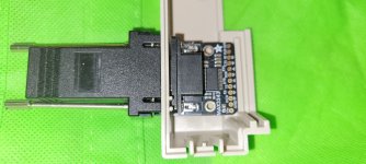

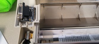

I obtained a 707 and am adding the DB9 full pinout board from Adafruit. There is a signal line that goes to pin 9 on the modem chip. Taking it low though a tiny DPDT toggle switch will tristate the RCVD line. The !FORCEOFF of the Adafruit board ground should be removed when needed for direct RS232. DTR needs to be asserted for the computer to communicate usually as well.
Interesting I didn't this was a thing. Do you have a link? I'd like to look into it.

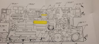

Page 88 of https://archive.org/details/bitsavers_titerminal1Model703707DataTerminalsMaintenanceManu_12495052 has the schematic.
Pin 9 of U4 TMS99532 when brought low puts the RCVD line in high-impedance state. Use one side of a DPDT switch.
Normal use of modem connect pin 10 of U7 back to the modem thru the DPDT switch.
https://rocelec.widen.net/view/pdf/cusmx16t28/TXIIS145563-1.pdf MODEM chip
https://www.adafruit.com/product/5988 Uses the MA3243 level convertor.
https://www.ti.com/product/MAX3243
The Adafruit PCB unfortunately extends beyond the connector shell and needs to be trimmed flush.
Wire !FORCEOFF low when the 707's modem is being used using the other half of the DPDT switch.
Connect DTR to Vin so your computer knows when the 707 is powered up.
Jumper RTS to CTS if needed by your computer.
I'll try to post more pics of my installation soon.

Correction: 3PDT you need CDET to be switched to ground when using RS232 as well.
I changed the schematic and am posting it here.
The three important lines are only switched.
The highlighted chips are the ones of interest.

The best spot to mount the serial board is on the lid's left side over the modem's transformer.
Be careful when drilling the two holes and milling the opening for the connector, the plastic may be brittle with age.
The toggle switch will be mounted nearby.

A RJ45 to DE9 connector now can be attached to the serial board.
The 3PDT toggle switch fits in the space next to the board.
