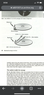

It would appear that Sony uses the term "CCW" in different ways. CCW in that they're all Continuous Composite Write-Once disks. But "CCW" must also mean something else to Sony. They even have "CWW," whatever that is. I guess for Sony, they mean their -B suffix disks. Some examples:
CWO-1300B
CWO-1300C CCW
CWO-5200C CWW
I don't know what the heck the difference is. But I think that with WORM media not being compatible between different vendors would be a pain in the butt. Which is a shame because the media is comparatively cheap.
Hopefully there's some commonality between the Sony -B disks and the media produced by IBM, HP, and Plasmon (which all seem to be the most common.) IBM's technical website makes zero distinctions between its different WORM media. It just states to assume they're all "CCW" for SD, DD, 2x, 4x, 8x, etc., but I don't know in what context they're using "CCW."
Edit: I'm wondering if "CCW" and "CWW" are media that are written to more like a tape drive. The raw data is auto-compressed and accessed via an intermediary that recovers it. That's in contrast to using it more like a write-once HDD.
I'm wondering if there are two types of abbreviations relating to 5.25" optical media, that are the same letters, but mean different things.
CCW is referred to as Continuous Composite Write-Once. I've also seen it referred to as "Counter Clock-Wise" in documentation. I've also seen "CWO" referred to as "Clockwise Orientation". Again, if anyone can fully determine what these acronyms are, they should receive a medal.

CCW is the generic term for counter-clockwise or (if you're in the UK) anti-clockwise. It's also an abbreviation for a host of other things, such as Channel Command Word (IBM S/360). Since it makes no sense that a drive maker would go to the trouble of spinning the disc in the opposite direction from the rest of the industry, I'd take the "Continuous Composite Write-Once" definition to be the preferred one in this case as it's sometimes referred to as "CC format WORM"--an acronym within an acronym. The "opposite" term would be SSW for "Sampled Servo WORM".
Read this summary and the standards it cites and get back to us here if your head stops spinning.

If there weren't drives spinning the wrong way, Sony would not have needed to include a line specifying the direction of rotation for discs on their marketing brochures.
