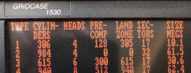

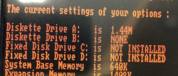

You got a 1530 to boot from a CF card?!? That's my holy grail!
I have one with an intermittent Conner failure (more down than up...) that occasionally still boots. I'd love to do what you did.
Any chance you can share your patched BIOS? I have a 512MB CF card, so am I right in assuming it would use the same C/H/S values yours did?
