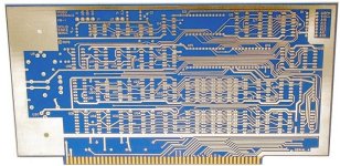

Question on SSM VB1A video board (Not VB1B or VB1C):
This is a long shot, but I have recently built up a Solid State Music VB1 board using the schematic and parts list for the later versions of this board (ver. B) and discovered there are version differences and the board did not work.
There seems to have been small changes to the design in the later revisions. In particular, the IC's used are different for the version VB1 board I have (S/N VB1A 005).
I started trouble shooting by tracing the crystal timing circuit with a scope and where the crystal signal entered the IC's made no sense ( going to an output?). So after following the board traces and looking at the IC's that the designers used, I saw that by switching out some IC's (U31) the circuit made more sense and sort of worked. The timing is now double what it should be as noted in the theory section. So there must be other IC's that are different between the bersion A and the version B boards.
My question - does anybody have just a "parts list" for the SSM VB1 board...not for the VB1B or VB1C but the original VB1. I know this was sold for a while as there are ads in old issues of Byte magazine.
So if anybody has this info or knows of a website that does; it would be appreciated and save me from having to trace out the entire VB1 board.

What ever became of this board? Did you identify the differences between it and the B version?
SSM VB1A Video Board...
"What ever became of this board? Did you identify the differences between it and the B version?"
Yes, I found an old parts list from SSM which listed all the parts for the VB1A and it is substantially different from later boards. After populating the card with the correct parts I do get a display output from J2 to an Apple IIc monochrome monitor consisting of text characters that change depending on the settings on "S1". The video output doesn't make sense to me at this point so furthur de-bugging is required. I got side tracked restoring an SD Systems "VDB-8024" but hope to get back to the SSM board soon.

Were you able to get the full user's manual for the VB1(A)? or just these two pages?
I have just finished resurrecting a VB1C and VB1B so I am now really curious about the original VB1A
-Craig
Hello Craig, I don't think I will be of much help in finding an original SSM VB-1 manual as the board I
have was purchased from Anchor Electronics as a "found in the warehouse" deal with no documentation at
all. The information I did find was from a sales flyer for several of SSM products (memory cards, video
card etc...) but did have the parts list I needed but no other information or manual. From what I can
tell, the main change to the card was using a 12.3Mhz crystal instead of the original 20.0Mhz crystal on
the board I have. The newer boards used the same chips just in different places to accommodate the
frequency difference as I suppose they did not want to redo the entire board. They also added pull up
resistors in a few places (R23=1K) installed in later boards. I did draw up the VB1(A) layout but did not
trace out the original schematics. I have never found a manual for the VB1(A) card I have but have seen
photocopies of the manual pages on an Ebay listing (3/24) so I suppose it is out there somewhere. If you
find one please let me know.

I see. The layout was your drawing. I missed that.
do you have pictures or scans of the front/back before building? If they were trying to minimize changes, maybe it will be easier to compare to the VB1B and find the differences rather than starting from scratch.
regards
craig
Craig, these are the images from Anchor Electronics of the unbuilt board.
>>> Charles

Very good. When you get back to this project, let me know.
Also, I presume you checked with Herb Johnson to see if he has any VB1 documentation?

Craig, I did find Herb's site where he discussed the SSM products and his documentation page only listed the SSM VB1B card. I did not Email Herb just read the information he noted about conversations with the SSM developers/engineers.
