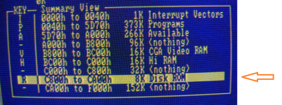

Before going down the 'the BIOS expansion ROM in the IBM Fixed Disk Adapter is not being executed' path, we should verify that the subject ROM is actually appearing in the computer's memory space. I see that you have CheckIt 3. In CheckIt 3, do you see the IBM Fixed Disk Adapter's ROM (resides at address C8000) when you use the menu path of: {SysInfo}{Memory Map} ?
If so, you do have 'take that with a grain of salt.' I could probably put any BIOS expansion ROM there, and because it resides at C8000 (sometimes indicated as 'C800' or 'C800:0'), CheckIt will consider it a "Disk ROM". And I doubt that CheckIt will verify the 8-bit checksum of the applicable area of a BIOS expansion ROM.

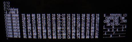

Using DEBUG is another 'gaining confidence' thing, as shown below, looking at the first 128 bytes starting at address C8000.
Per [here], the first two bytes are 55 and AA, an indicator of a BIOS expansion ROM.
No nothing
Same with debug.
The whole content seems to be empty with FF
No nothing
Same with debug.
Card known to be functional. So the question now becomes, "Why isn't the card's BIOS ROM appearing in the 286 motherboard's memory space?"
Rhetorical: Is the ISA slot too fast for that card (a card designed for XT-class machines).
Rhetorical: Is the problem mentioned in post #8 at [here] in play?
