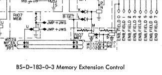

I was reviewing the F-87 print set in hopes to learn more about the Straight-8's memory extension to see the likelihood of recreating it (and the Type 184 memory modules) for those of us with 4k Straight-8s.
In the print set, PD02/MD35 pin H ends up driving ENABLE FIELD 0. I assumed this might have been for enabling field 0 with no memory extension.
But then I looked at the signal on the line...
To my surprise, it's OPR, which is asserted during an operate instruction.
That makes very little sense to both Vince and myself. What about field 0 should have a dependence on OPR?
Perusing the 183 description as well as Operate's description did not suggest anything obvious to me. Maybe I missed something.

If it's like I remember, there is a set of bytes being assembled in memory. As each bit comes in, a data break RMW is done to get the byte, rotate it (with carry-in or not), and rewrite it. When bytes are fully assembled, interrupts are generated, and the interrupt service picks up the assembled bytes. Similarly for output. Possibly the gates you are looking at are a support kludge to force field 0 for those data breaks. But really it seems more like the more proper thing would be for the terminal controller to set up address_extend[1:3] so the break decoder at mc3. would do the right thing.
Unless, somehow opr inhibits b_set.
I don't have a way to make F-87 text searchable right now, but it would be interesting to see what mentions of slot ME8 exist.
I did manage to pull together a list of the signals that I think were meant to be routed to the 184 memories. Looks very similar to the MM8/I bus, from what I can see, except that it's got both polarities for MA, and the field select is pre-decoded. I'm guessing that BMB was picked up from the Negibus slots?

That would be my assessment. I didn't know about the field 0 select Kyle mentioned so it might be that you would have to remove the card that originally drives that? Not at home so I can't just go look. It could also be that when 183 is installed a wire would be removed from the backplane. I can't imagine that adding a 183 and 184 to a machine would have been done by anyone but field service personal.
20 cards in MC through MF, 1 to 5, plus 7 more in ME/MF, 6 to 9, plus 15 more in MA through MD, 31 to 35. So 42 cards total, plus presumably 9 paddles for cables.
MD35 (a processor/memory chassis cable) is asterisked as a Type 183 only slot, but its mate, PD02, is not.
I'm assuming as Vince mentions that BMB comes from the I/O connectors (I think Doug mentioned this elsewhere as well), but the two I/O connectors with BAC (and other signals) are not necessary—BT1 is duplicated for the memory connector.
