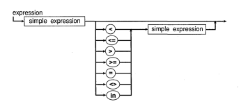

all statements can be reduced to groups of operations with just two operands.
Well, this can be seen here.
Consider the TP 7 grammar talking about expressions.
I mean that's it right there in a nutshell. An expression has 3 parts, 2 of which are optional. A Simple Expression, and, optionally, an Operator and another Simple Expression.
This defines every expression in the language. As you can imagine, things start getting more interesting as you dig in to the definition of a "simple expression". You'll notice, there's no math here. Those are defined deeper. It's a recursive definition that will eventually come back in to wanting, potentially, more expressions. Since Pascal historically uses recursive descent parsers, the different syntax elements automatically handle issues like precedence. A Pascal expression is built of of Simple Expressions, Terms, Factors, Variables, Constants, and Identifiers. Out of 6 pages of syntax diagrams for Pascal, 3 of them are dedicated to expressions.
But, as you can see, at the top level, it's 2 elements and an operator, just like you see.
If you follow it to its conclusion, it's straightforward to convert a normal expression in to an "RPN" (Reverse Polish Notation) style expression, also know as a "postfix" expression, which is ideal for a stack based evaluator (in contrast to a register based one).
