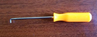

after making myself a custom ram removal tool RamTool_thumb.jpg from an old cheap pick tool with the end snipped off, I removed all the ram, cleaned the pins, cleaned the sockets, and re-installed it all and it was found properly.
for anyone that runs into this, the openboot config lists the memory locations of the bad chips, but the mapping is not 'sequential', so you need to pay attention to the number, and make sure you are working with the proper chip.
