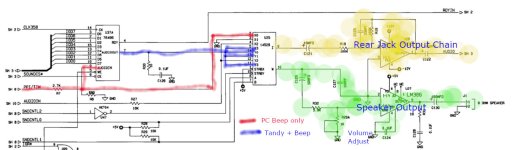

The relevant page of the 1000SX's schematic is sheet 7. (You will notice that it doesn't quite match up with the functional diagram in Figure 8; this is confusing.) The NTE4529B I mentioned is a dual 4:1 multiplexer that can also act as a 1:8. IE, it has two sets of four inputs that can independently be switched to select which source goes out an output, or it can also select a single input from all 8 that will go to *both* outputs. Even though there are 8 inputs there are four options:
1: PC sound only
2: PC sound mixed with the output from the SN76496 (this is accomplished before the multiplexer; look at the schematic, a branch of the PPI/TIM line feeds into "AUDIOIN" on the sound chip.)
3: Sound from the proprietary "AUDIOIN" line on the expansion bus. (I don't know if anything ever actually used this.)
4: Grounded, IE, nothing.
And because of the sort of weird way it's wired not every choice can be independently selected for each of the two outputs, which as you can see in the schematic one of which goes to a preamp in front of the audio out jack and the other of which goes to the speaker.
My operative theory of what might be happening is that multiplexer is stuck so it's in a mode where "PC sound only" is being provided to both audio outputs regardless of what the control lines are telling it to do. I think the only reason you can hear the Tandy sound faintly on the audio output with an amplified speaker is essentially a small amount of signal is "leaking" through, not enough to be audible on the speaker but you can pick it up when you amplify it enough. If I turn up the volume enough on my Tandy 1000HX I can hear all kinds of subtle interference sounds so it wouldn't surprise me a bit if noise from the Tandy sound chip can leak through even when it's unselected.

Here's an annotated schematic of the sound routing through the multiplexer chip, showing the two output chains. I've marked that volume pot on the schematic (I watched a video showing adjustment of it so I'm confident this is the correct component), so you can see that if the multiplexer was set to output the mixed Tandy/"PC Compatible" sound to the internal speaker turning that knob would affect both of them. There doesn't seem to be any other separate trim knob for either the PC sound or the Tandy sound chip before you get to the multiplexer.
... If you have a logic probe it might be worthwhile to check the state of pins 15, 6, and 7 on U25 when you think the system should be outputting Tandy sound through the internal speaker. If I'm reading the truth table in the 4529B datasheet correctly the only circumstance under which you should get *only* PC sound from the internal speaker would be if all three of those pins were logic low. (Which would also only feed PC sound to the rear jack.) If the pins are in any other state then the multiplexer is almost certainly broken.
If those pins *are* all zero when you think the machine should be outputting Tandy sound then that may indicate the source of the SNDCNTL signals is broken. That would be bad because they come from the proprietary Tandy keyboard controller IC.

Thanks this is helpful. I disconnected my external speaker and to my dismay, the PC beep is not being output to the PC speaker either. So loud system beep, quiet 3-voice Tandy sound from rear external output, nothing from the PC speaker. 😭
Wait... so was the built-in speaker beeping and now it's not, or were you never getting any sound from the built-in speaker but you thought you were because you were hearing a loud beep from a speaker plugged into the rear port?
