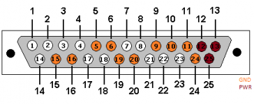

Havn't replied in awhile but I've been working on this Burroughs and I think I have it powering on... Main chips start to get warm and the red LED on the front powers on... But otherwise I have no idea... Since I don't want to spend around 100+$ on a terminal for this thing yet... I decided to try and decode the video out port... Which is a DB25 connector... and from what i have researched thats a Burroughs thing... and not common at all...
Since I don't have an oscilloscope this becomes even more fun... I figured out GND and PWR pins leaving 12 signal pins or what I assume are...
I then took DC voltages of each of those pins to get an idea of voltage range and to figure out what I'm working with... Sadly I cant trace the connector back to a chip easily there's wayyy to much going on... But I do know the video boards main chip is a mc6845p which is apparently a common video chip that was used in IBM video cards for DB9 CGA video I think? But anyway most of the other chips I couldn't even find datasheets for so tracing it was a dead end... But here I'll post what pins I do have traced and average voltages coming from them in DC compared to the pin and GND.
1-0.3
2-0.05
3-0.05
4-5
7-0.2
8-0.2
14-0.2
17-0.2
18-0.2
21-5
22-0.2
23-3.5
Hopefully someone can shed some light on this... I'd love to see this thing running on display instead of just staring at a red LED...
Oh I'll probably make a separate thread for the Burroughs under the Other section in a bit just to let you know.
Oh also by the way the plug on the board for the video is a female DB25 so that image is as if your looking right down onto it pinout wise... Atleast I think thats correct...
