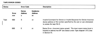

I can issue a REWIND, and it sometimes works (the tape physically spun). Other times I get ERROR 003 E80. On a "brand new" tape, is REWIND necessary? I know there are "BOT" and "EOT" markers that are supposed to be on the tape media itself.
UTIL doesn't work for me, since I assume it identifies there is no content on the tape.
If I remove the tape and try certain commands, I get ERROR 005 E80 (i.e. it is identifying the presence and non-presence of the tape)
I just insert the tape until I hear a couple light "magnetic clicks".
MARK 3,2,1 command is also giving me ERROR 003 E80.
Page 4-96 (page 218) of the MIM located here: <<http://www.bitsavers.org/pdf/ibm/51...er_Maintenance_Information_Manual_Feb1979.pdf>> states this...
Could it be the 3M DC 6150 tape is incompatible or just bad? (it's a "new stock" 150MByte 620ft version)

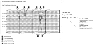

I think the Tape Status byte is a couple columns after the "5566" entries on row 5 and row 6 of the registers display.
I'm not 100% sure on which way the bits go, but I think "86" is Cartridge in place, and LED OK, and File Protected?

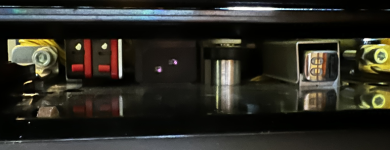

Ok, so peeking inside, everything looks clean and intact. I see the two infrared LEDs.
But then I noticed something out of place... It's hard to see in the prior image, but the black wire on the right isn't secured. I used a wooden chopstick to move it out a little, to get a better image. I assume this is a ground wire, which I could secure to just about any screw in the area. I'll probe around a little bit more - with the case cover off, I can get to this black wire from the outside. But it's short, not much room to work with. Anyone happen to have a photo that might show the proper location for it?

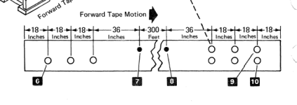

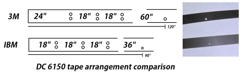

The system was "unrolling" the 3M tapes completely off the reel (before the fix). So, I used one of them to examine these BOT (beginning of tape) holes. I also have a non-functional IBM tape, so I took it apart as well to compare. Here is what I found between them (at least for the beginning parts):
In regards to distances from the beginning of the tape to the double and single marker holes... (not to scale)
NOTE: One other minor point - on the IBM tape I could see "seams" consistently about every 5.2 inches. You see one of these in the single-hole comparison image right above (the one with the smaller hole on the bottom is on the IBM tape -- the seam is slightly to the right of that). On the 3M tape, I couldn't notice any seams.
The IBM distances I measured are consistent with the MIM:

And, both LEDs seem to be working...
Maybe it's just the extra distance the 3M tape has (60" vs 36") is throwing it off (to perform the MARK)?
I think it's unlikely to be the extra distance; again, 3M 6150 tapes work fine in my machine despite all their differences. I don't think the 5110 is too likely to be different to the 5100 in this regard.

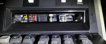

In case it helps, here's a fairly unglamorous look into my 5100's tape drive
It looks quite similar, although IBM appear to have added a metal shroud around the tape head for the 5110, maybe for EMF shielding or some such.
ETA: Looking at both pictures, I can't help but think that your tape head might be angled downward slightly? I think that the face of the tape head wants to be at a 90 degree angle to the bottom of the tape drive slot. Is it an illusion (caused by e.g. the positioning of the metal shroud) or is it real?
