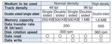

I would be happy to get it working as a 720K drive just to see the device show up during startup. I've tried just about every jumper combination available. I just don't think the floppy is reporting a "Ready" state to the controller for some reason. I'm almost leaning to the idea that that part of the floppy is not working properly. Those pins U0, U1, U3 are not used in the PC world, but these SCSI floppy need those jumpers set and working to be configured correctly. I think I'm going to try to find another floppy drive and see.
The 55GS brochure says it will read all modes but will only write the 96TPI formats - which is interesting. I thought that this would be something the SCSI bridge would handle, but you might be right in that it's wholly dependent on how the floppy is configured.
