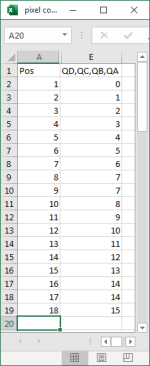

Today I made some more progress with my Tek 4010.
I desoldered diodes CR90, CR92 and CR94 on the HV & Z-Axis board inside the display unit. These generate the grid voltage to control the brightness.
CR90 and CR94 tested bad.
I replaced all three diodes with UF4004 which has a Vrrm of 400 V, If of 1 A and a maximum trr of 50 ns, but a somewhat higher CT of 30 pF compared to the measured 6 pF of the original.
Today I also again replaced CR130 which tested bad yesterday and which as an experiment I replaced with a standard recovery 1N4004. It worked ok, but a UF4004 is a better choice.
After reassembly and power on I had nice control of brightness via pot R130.
Characters typed are visible and persist. Cross-hairs are visible but don't persist (mostly) when you move them around.

Of course there are still problems:
- After 10 characters typed the cursor backs up two characters and if you continue typing those characters are overwritten. This repeats 4 times across the screen (I typed 3 lines of "A" without and spacing).
- After 19 characters typed the cursor jumps two characters forward. This repeats 3 times across the screen resulting in 4 columns of characters visible.
- The X cross-hair display correctly, but the Y cross-hair shows the same type of over-type as the typed characters. This leads to persistence of the "over-typed" segments of the Y cross-hair.
- The Y-cross hair also exhibits the skipping of segments in the same horizontal positions as the typed character line.
