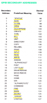

Al Kossow posted his scan of the Tektronix 4924 Tape Drive Service Manual on bitsavers last fall:
http://bitsavers.org/pdf/tektronix/405x/4924/070-2131-00_Tektronix_4924_Digital_Cartridge_Tape_Drive_Service_Manual_Feb1982.pdf
Appendix A, B and C contain great information on the 4924 GPIB commands including byte-by-byte sequences for each command.
Here is the first page describing GPIB sequences to the 4924:
attachment.php
This will be incredibly helpful in emulating the 4924 with an Arduino board and SD Flash!

Learned another thing about the Tektronix 4050 tape drives including the 4924 tape drive:
The 4924 Tape Drive GPIB sequences above includes an "ERROR" command - that is undocumented. The description of the ERROR command is also in Appendix B and indicates the 4924 (and likely the internal tape firmware) include a checksum on each 256 byte record.
The 256 byte tape records have an additional checksum byte: per the 4924 Service Manual Appendix B- screenshot of that page:
attachment.php
This checksum is computed and added to the record when a record is written to the tape and checked when a record is read from the tape.
A checksum error will automatically cause a retry of reading that record. After ten retries with the checksum error - BASIC will report an error message.
Performing an INPUT @2,24:E (for a 4924 with ID of 2) will return the accumulated number of read errors and clear the error counter.
Using a 33 for the ID may return accumulated read errors for the internal tape drive.

The text in red is the command - I have added the Tektronix commands to the AR488 Prologix GPIB commands for this test. When we get the full program running, the commands will come from the Tektronix computer over GPIB and the output will be sent back to the Tektronix computer over GPIB instead of being sent to the serial console.
You will notice in the first OLD command that line 1090 has two linefeeds inside the PRINT statement, and in the second OLD command line 1040 has multiple BELL control characters.
These three Tektronix BASIC commands are the minimum to use the emulator as they allow you to see the files (TLIST), select a file (FIND) and run a program (OLD).
