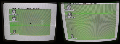

Next, Overscan. I read in an Atari magazine review that you are supposed to put Overscan.PRG into the AUTO folder of a floppy disc. I didn't have the VIDEO50.PRG but I think my ST boots in 50Hz color mode anyway.
When I boot with the floppy disc in place or run Overscan.PRG from GEM, I get "Overscan Version 1.6. NOT activated."
I don't see any overscan magic in GEM. I have no real background from this PRG; maybe it is from an Overscan that had the manual switch? Or I'm doing something wrong, or there's something wrong on the hardware level. I'm stuck here.

Aha, I've made it onto the Atari forum. It seems I downloaded an incompatible Overscan driver earlier. I'll try again with the one I found now.
I've downloaded the other Overscan driver ZIP, which was labeled as belonging to AutoSwitch Overscan and contained a nice AUTO folder. Managed to create an empty disc with said AUTO folder, and...ta-dah!
Good to know that if I ever plan on doing anything that can use the extra screen space, it's there.
You found it by yourself, you have to start it before the desktop is started, otherwise it can not install/enable it. AutoSwitch Overscan is even more powerfull in monochrome monitor, you allmost get 800x600, to be exact, up to 762x576.
