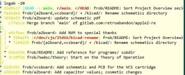

@btb I have commit up on a branch dev/cjs/25d16/kicad-rename to merge both the KiCad projects (a2board and vcsboard) into a single kicad/ subdir, which I think is a bit more clear from both the ls point of view and helps keep the number of directories down. I don't see any particular issues with this, since I'm sure I've done several different KiCad projects in one directory before, but I just wanted to check with you before merging this.
If you see no problems, you can either rebase this on to main and do a fast-forward "merge", or I'll do it. (It's basically just, git fetch && git rebase main@{u} && git push origin @:main.)

I can definitely test and make sure the board works as intended, so I would like one of those boards.That sounds fine to me. I don't really have my head around the @{} syntax, so I just did a regular "git merge".

Lol, that leaves things even more confusing. You had added a commit to your main, then merged that with the "real" main that did not have your commit, and somehow later on add copies of my commits from the branch to main (without doing a merge, i.e., in the "right way") anyway.That sounds fine to me. I don't really have my head around the @{} syntax, so I just did a regular "git merge".
Yes, so you're basically doing the same thing I suggested anyway, except that before that you really want to git fetch && git checkout main && git rebase to make sure your main is up to date. (On the branch, git rebase main@{u} is basically a shortcut so you don't actually need to update your local main: just use the upstream version.)My usual method of merging a branch locally is to 'git checkout thebranch', then 'git rebase main', then go back to main and 'git merge thebranch', which is what I did after that.
