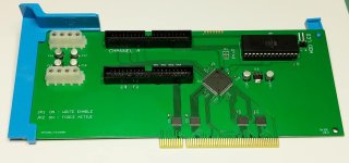

I'm guessing this means about the development of the microchannel IDE adapters, not about the older implementations of limited drive tables - there isn't much online. There was someone with an ASIC design already prototyped on the PS/2 Facebook group, but I don't know how it is progressing. It has been some time since the last update (this is from almost two years ago).

I would wager a guess from the parts on that picture that they might be using the same CPLD code, or a close copy thereof, that the Snark Barker MCA card uses. And if their card is actually decoding the "standard" IDE primary/secondary/tertiary ports then it's possible that the software on that ROM is just a slightly hacked (or maybe not hacked at all) version of the XTIDE BIOS. But again, if they just disappeared after posting this we might never know.
Why it would be interesting to have the schematics of the older cards that just use plain TTL logic and PALs is it might generally make it more comprehensible how to interface something to MCA without the need of a CPLD or an unobtainium bridge chip, but I suppose one could just work backwards from what the Snark Barker's CPLD does.
(IDE ports in and of themselves are very simple, so the question is just how much glue it takes to get one talking on MCA after you've done the address decoding, and I guess I just don't know off the top of my head how hard that would be because it's been a long time since I did any reading on it. I vaguely remember that interrupts are slightly different and I don't know what you need to do with the arbitration lines if you want to just drive a PIO device like IDE in one of the "simpler" modes.)

As David indicated the project for a modern IDE MCA card is now live and well and selling like hot cakes (no doubt) see the McIDE options from zzxio
There’s two variants at this time one with CF slots and another with pure IDE connectors I believe there are other projects still in the works.
I believe it to be a joint project from those initial screenshots captured earlier in the chat by Graham ‘Graz’ Sellers and collaborating to get it out there with Mark Malley and many other testers like Shane Benting etc..
