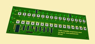

Could somebody with a ti-990 system with a programmers panel take some pictures of the rear of the panel, i'm hoping it has some component designations on for the LED, it's not clear from the schematic if they are in the same order as they are on the panel.
I'm building a pcb for a replica programmers panel to connect to my 990/10A processor board.

I have a panel - will try and get some pictures for you this weekend.
No silkscreen on the rear of the PCB, and this is the best shot I can shot without dismantling the PCB from the front panel. reluctant as I don't want to have to faff about aliging all the LED's and switches back up.
Thank you very much, that should do, since i have the schematic hopefully i can trace the tracks from the LED's back to the shift registers on the picture.
I only need to be able to trace a couple to confirm the led order.
I wouldn't expect you to take the PCB off.

Thank you, I have been able to follow enough tracks on the picture to confirm what i needed to know.
Despite the LED's being labelled (left to right) as Bit 8 to Bit 15 and then Bit 0 to Bit 7, that is the correct order.

Here is my recreation of the programmers panel for use with the 990/10A pcbs.
It's not intended to be an exact copy, it's smaller and i have used SMT caps and resistors. But the circuit is 100% the same.

Here is the real version of my programmers panel.
A couple of issues on the Issue 1 board, should be correct on the Issue 2 schematic which i've attached.
The circuit is an exact copy of the TI panel but it's laid out to no specific size as as the time i didn't have a chassis it needed to match.
