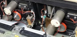

Good news! Jos Dreesen printed a second run of new rubbers for my TU60 drive
and these works like a charm! I will do some extensive data testing later but this looks
very promising. This is very good to reproduce. Good hope for the TU60 drives in the field!
I have two of these drives here but not all PCB's seem to be okay. But with a bit
of board swapping I got al least a working set. Now I can repair the defective boards.
And I'm very happy that my clone controller works well ! :D:D:D
Here is a little video of running the maindec.
Regards, Roland
I do hope they last , to be honest I have no idea if these are a long-term solution or not.
Then again, it's an easy job to print more..
Jos

Yes it is a bit different, I'm quite happy that the computer and tape drive just fit on my desk ;)
There was still an error in one board generating CRC errors. This was caused by a defective 7400 in the TU60. Now fixed.

If I remember right, I sent Mattis a rubber seal from some pluming that worked out just fine.
Do you recall any more specifics about that? My TU60 rubber has turned into a strange fragile whiteish mass cracked into multiple segments and fallen into the chassis. None is left adherent to the metal wheel. No idea how firm it was originally.
I'm guessing that your plumbing diameters are metric-based and are different than ours here in the USA :-<.
Jos
Assuming that they lasted this far (three years now) perhaps I could acquire a set from you? My TU60 rubber has turned into a strange fragile whiteish mass cracked into multiple segments and fallen into the chassis. None is left adherent to the metal wheel. No idea how firm it was originally.
What material did you use to print these replacements? Is the STL available?
I do not have a TU60 : other than "it works" i have not received feedback on how well they keep up.
I'll append the .scad file for this and some others rollers I have made.
Material I used is Ninjaflex TPU 3DNF0517505
Print @220 Celsius with 90% infill, using half-speed (30mm/s) and check feed cartridge.
It does not make economical sense to ship these from Europe to the US.
BR Jos
