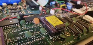

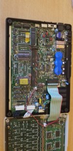

Here is the view of the main board. You can see my NSC800 adapter and the adapter for a revised main ROM.
Closeup of the NSC800 adapter:
Closeup of the main ROM adapter with the slightly revised Microsoft main ROM.

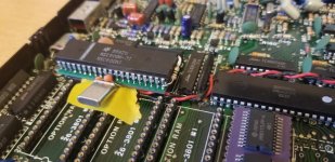

And finally, the complete system, which happens to be running Turbo Pascal 3.0. You can also see the VT100 adapter converting console serial data to VGA.

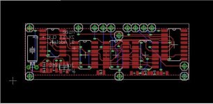

Minor update!
I have implemented a 2x speed up board .. aka CPU adapter... for both the 80C85 and the NSC800.
With either of these boards you can run at 4.9 MHz.
The board are just slightly larger than the CPU and easily plug into the socket of the 80C85.
It is kinda fun to run 2x faster. Should have been that way to begin with!
I'll have to post some photos.
In experiments I was able to run over 6MHz, but generally you need faster system rom and ram.
The video drivers fail around 8 MHz, which really was the limiting factor.
5MHz was a nice tradeoff.
Well, in a nutshell, you need to change the timing circuit. You have to drive the cpu with a faster clock but maintain a 2.45 MHZ clock on the CLK output signal.
On an M100, to double the speed to 4.9MHz, you also need faster RAM and a faster main ROM. I believe a T102 already has gast enough memory.
I made an adapter board to do changes to the CPU
To install it you need to, for this design, to desolder the CPU and install a socket. Then the adapter board can plug in, with the CPU soldered into the adapter.
I'm thinking about an alternative approach though, where you just clip the X1 and X2 pins, and the CLK out pins. That way you might be able to just piggy back a small board with the crystal circuit on it.
You interested it trying it out Mike? I can send you some parts.
You can use one of your 27C512 adapter boards for the faster main rom.
For RAM, REXCPM does that nicely. Otherwise as you can imagine getting faster system RAM in an M100 can be a bit of a chore.
My only use case for NSC800 is in a dedicated CPM machine.
One last comment. 4.9 MHZ is nice ad it is 2x. But the ram and main rom seem to support up to 4MHz. So that could be an approach. A tidy 60% improvement.

I've actually been working on a carefully designed 5MHz upgrade board for the TRS-80 Model 100.
My first 5MHz upgrade designs ran into a challenge on some or all M100s. Here's what I found.
1) the "stock" main ROM chip is quite slow - 600nsec - and as such I think one must replace the main ROM with a faster PROM of some kind. Lots of ways to do that.
2) the "stock" system RAM modules can be quite slow also. Anything that is 200nsec or faster seem to tolerate running at 5MHz. However the earliest M100s were shipped with RAM modules that have 250nsec SRAM parts. Those are just a tad slow.
So, what to do?
One could replace the ram with faster RAM. It's actually a bit of work because there is always one or more RAM module soldered in. So if you have to pull it, or otherwise modify the ckt to disable it, that is a fair bit of work.
A nicer way to go would be to find a way to make the built in memory tolerate running at 5MHz.
Is 250nsec an issue? Well the fastest Read cycle on the 80C85 is 3 clock cycles, which at 5MHz is about 600 nsec. So maybe a bit tight.
If we can chip-select early in the read cycle perhaps there is enough time.
Well, it turns out that a pretty simple change can allow us to change the main timing signal that interfaces the SRAM. (A* signal).
By advancing the timing by about 100nsec, you can give enough breathing room to the slowest SRAM chips so they can respond correctly.
My latest design is working very well and saves quite a bit of power.
What it is, is a small board that piggy-backs on the CPU. It supplies the needed CPU clocks for either stock 2.5Mhz or turbo 5MHz operation.
It also generates the one modified timing signal A*.
* increases the M100 power supply current from ~50mA to about 70mA
--> of the 20mA of extra current, 5mA is due to the new crystal oscillator ckt alone.
--> the system itself running at 2x clock uses only about 15mA extra.
* works with the stock SRAM modules
* does require that the stock system ROM be upgraded to a faster PROM (like 27C256)
* requires 2 cut tracks and 2 wires, as well as about 10 signals piggy-backed from the CPU
Anyhow it has been a fun little project to dig into and optimize.
Yes, 70 mA is 40% more than 50mA, but I think for usability it is worth it.
You can combine this mod with my "fast hardware scroll" modified system ROM image to really speed things up.
Especially since you have to swap the ROM anyhow.
I'll eventually post some info at bitchin100.com that will provide instructions and access to a board.
cheers

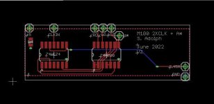

Bit more info on 5MHz adapter boards. Here are some small layout pics with descriptions. These are "current".
1. Fixed 5MHz 80C85 adapter including A* circuit. Used for stock M100/T102 upgrades, and supports old/slow M100 ram modules.
As you can see, two 74HC smd parts. Pretty simple, works well, but you run the risk of wanting to run at normal speed and being unable to.

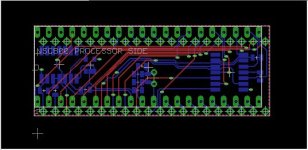

2. Fixed 5MHz NSC800 adapter. There is a whole set of info here on this conversion: https://bitchin100.com/wiki/index.php?title=NSC800_Conversion
Some SMD soldering, new crystal, etc. More surgery, but fun for CP/M. Z80!
3. Switchable 5MHz 80C85 adapter including A* circuit, based on 74HC SMT.
Pretty dense layout, lots of small SMD 0805 + a tiny 5 pin unbuffered inverter for the crystal ckt. Tougher to make, but flexible.

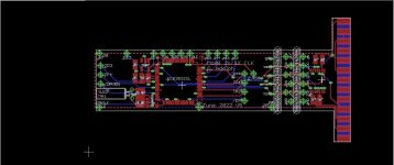

4. Switchable 5MHz 80C85 adapter including A* circuit, based on 3.3V CPLD.
The best design, very very flexible, but a stretch for the hobbyist. I used this one because it is the lowest power adapter.
on the right, there is a JTAG circuit that is detachable, that is used to program the CPLD. Since the CPLD has a lot of resource unused,
I have lots of extra I/O pins to do custom things. Most are not used.
Any fast M100 usually needs a faster main ROM. Early production used slow PROMs, later ones are faster.
If you need a faster main ROM, there are lots of ways to skin that cat.
