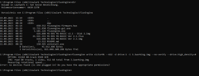

Hey all, getting back to the TEAC 55-GFR drive, with some suggestions from David G over at the Fluxengine GitHub repo, I figured out how to write a disk that works. The command:
fluxengine write victor9k --612 -d drive:1 -i 3.1working.img --no-verify --drive.high_density=0
Worked to create a bootable floppy. The --no-verify option tells fluxengine not to verify what it's writing and the --drive.high_density tells it to write a Double Density disk as opposed to a High Density one. Can you guys give this a shot and see if it works for you also?
Hi Paul,
thanks, I will give this a try tonight.
One question:
As the former command fluxengine write victor9k --612 -d drive:0 -i "MS-DOS MS-BASIC Ver 2.1.img" contained exclamation marks for the file name to be written and the new command above does not have any excl. marks, is this making a difference?
Sorry, maybe stupid, but as a mechanical engineer my script knowledge is very limited.
I have renamed the former file into 3.1working.img and had tried this without the GW at hand, the result is attached, so I am very curious.
Thanks,
Martin.

Hi Paul,
One question:
Thanks,
Martin.
The quotes are needed when the file name has spaces in it. As Pauls last example was all one word 3.1working.img it didn't need the quotes.

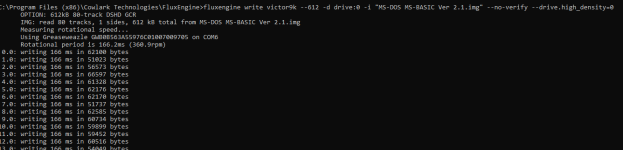

Hi all, good news! :)
I managed to create a boot disk with the following command:
fluxengine write victor9k --612 -d drive:0 -i "MS-DOS MS-BASIC Ver 2.1.img" --no-verify --drive.high_density=0
I wrote a Sony MD2HD (!) Disk and my V9K booted! Even the internal HD seems to work.
As usual, the keyboard is completely not usable, so my next task is to get it repaired
Please see pics attached.
Happy greetings and many thanks for the help, initial work is done now.
Martin.
