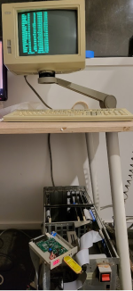

I'm trying to get a Gotek working properly on my Wang APC
I can boot fine from the Gotek, as long as I have the disk I want, selected at boot.
Issue
When I switch disks on the Gotek while booted into MSDOS, I get a: Not ready error reading drive A,
If I try to switch back to the boot disk I get the same error
Gotek Setup
I've flashed the Gotek with the latest FlashFloppy Release (FlashFloppy 3.42)
FF.CFG I've set:
interface = ibmpc
The drive select jumper is set to DS0 (this seems to be one difference between Wang and IBM Compatibles needing DS1)
Other things I've tried
I've tried both the connectors before and after the twist in the cable, both work but same result switching disks.
Changing the interface in the FF.CFG - e.g shugart - didn't work as expected
Thoughts
My floppy drive configuration knowledge was pretty much 0 before diving into this issue, from reading around, I'm thinking there's some issue around the drive READY or CHANGE DISK signals.
I'm not sure if the ibm interface setting in Flash Floppy provides a disk RDY signal, only a DISK CHNG on pin 34? - maybe the Wang expects a RDY but not getting it, Looking at the shugart settings, this provides a RDY on pin 34 and DSK CHNG on pin 2
Wondering if anyone has any knowledge around Wang Floppy Disk interface nuances, or if anyone might have some ideas around what I could try?
