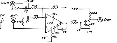

I looked at the schematic for the card the tape deck connects to and inspected the card, nothing out of the ordinairy visually there. Then looked at the drives schematics and noticed that the tapehead is drawn as just a coil on 2 pins, not really sure what I was expecting to be honest... but I always thought a tapehead was more then just a coil (although in hindsight, it does make sense, as I believe most read/write heads are coils too).
The logical thing would've been ages ago to just measure the resistance of the head while unplugged from the machine. It reads open, which I guess means that there isn't a coil left in the head. I tried to measure it both on the head itself and on the connector to the rest of the machine, both open. The wirering from the connector to the head are good. So... my best guess now is that the head is just dead. No fancy experiments with scopes needed i suppose...
EDIT:
Connected the head to one of those cheap Ebay multi component testers and that claimed there is a 255pF cap in there. Using a multi meter results in a simular reading, a cap of around 284pF.

The resistor that is in line with the WDT signal in the schematic of the tape drive has drifted quite a bit... it measures 6.4kOhms, instead of 5.6kOhms (the colour coding is correct for a 5.6k resistor).
I'll see about turning the machine one tomorrow and do some testing anyway. I wonder if i can connect the scope across the head and see if signals come through. That could at least show that the machine side has some function to it.
I could still do the original idea anyway to see if anything gets through.
Looking at the schematic of the card that has the tape circuit on it, it seems pretty simple. One side takes a signal from the machine through a set of transistors and out to the WDT (which goes through the write protect switch onto the head), I'd guess that is the write signal.
The other connects the 2 other signals from the heads through an amplifier and back into the machine. So I would guess that is the read side.

Regarding 5.6K vs 6.4K, I think those resistors are 20% tolerance (no fourth color band). In which case, 6.4K is within the 20%. The difference may not indicate any aging of the resistor, it could have been the original value.
