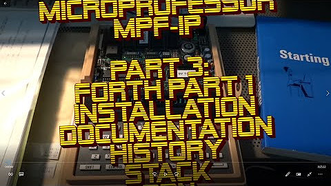

I did a series of videos about the MPF-1P Forth:

But you were right... I hadn't realized both Micro Professor units we have in collection are different - and as you stated forth is for the P variant, which comes with a nice printer.
Well, thanks for resolving this mystery. It would have been really nice if somebody had pulled of the impossible and indeed was crazy enough to implement a Forth for a HEX-only machine. You never know!
EDIT: The printer is optional for both MPF-1(B) and MPF-1P. The only difference being an EPROM. The MPF-1(B) printer EPROM comes with a disassembler listing program, which is quite useful given that you'll only see HEX otherwise!
