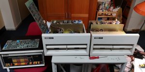

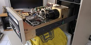

When I got my RK05 I thought that it would be a nice place on top of the PDP8/E. And this was the easiest way to put it in the cabinet. But when I got it all in the cables of the PC04 were too short to reach the controller again. And a while later got an eye on another RK05. That one is still waiting for me to pick up. I thought that it would be nice to have them on top of each other. That meant that I had two reasons to swap the PDP8/E and the RK05... :sleepy:

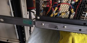

But the future RK05 needs all the rack space. So the power controller and 230-115V transformer had to be moved too. So these are placed in the top of the cabinet.
Now I have the space for the RK05 and below that one goes the RX02 floppy drive... While placing that drive I found out that I had the wrong cabinet slides. But there is a set waiting for me :-)

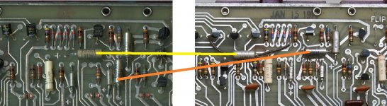

Speaking of which, it appears that C65 (39uF, installed horizontally up top) on the DEC boards is installed backwards! The marking ("+") matches the way it is installed, but the "+" end is at GND, and the "-" end is at +3V. (Maybe that's why the pull-up for the 3V supply is only 47 ohms, which is much lower than on other boards?)

Hi Vince,
I checked both of my M840 boards and you are right. That the capacitor is placed in the opposite
way as the PCB marking shows. But the + marking is placed wrong...
Left is - and right is + So the capacitors are placed in the right way...
Regards, Roland
A look at
http://svn.so-much-stuff.com/svn/trunk/Eagle/projects/DEC/Mxxx/M840/M840Kfront.jpg
will show that on my M840K, the capacitor is installed to match the markings (which as you say are wrong).
I also don't have that capacitor from 3V to the collector of Q3 (installed as rework on yours). What revision is that? (Mine is stamped "X S" in the plastic handles.)

Hi Vince,
It looks like you have that rework capacitor as well but integrated in your PCB already...
That rework cap seems to be connected to the -15V.
The other capacitor C65 seems to be 90 degrees rotated on your board. Quite confusing I have to say :D

I located my M840 and the cap appears to be installed + to + as Vince indicates his is. I ohmed the + side of the cap does appear to go to the omnibus ground. Whats the other side of the cap go to? In circuit my Fluke tells me that cap is 95.7 uf which is greater than the 39 uf listed on the cap. Must be paralleled with some other caps. It is a wonder that this cap has not blown up if connected reversed.
Probably to the bus on AB2 = -15V. Then the +cap to GND and the -cap to the -15V is completely normal.
Please check my earlier posting. I think we are a bit confused by board revisions. Vince has the
M840K and I have the M840F. That C65 has been moved over the different board revisions...

The cap appears to be C65 and is the bulk filter cap for a 2.5 to 3 volt supply they made on the board. Regulation is 4 diodes in series and so the drop is between 0.6 and 0.75 volts each. I guess 2.5 volts is the reason the cap didn't explode.

I have the M840K revision also. And that cap is C65 on the diagram which goes across the 4 diodes in series. It is definitely installed backwards.
