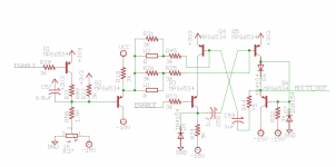

I have a number of questions about the bit of schematic attached. From the maintenance manual I gather that the circuit around Q2 models the ramp up of reader motor speed, affecting the clock rate to approximate the ramping motor speed.
Is there a discussion somewhere of what W1 and W2 do, and when I would install or remove them? I find the whole thing quite funky and I'm having trouble getting clear on what it does and how it works.
Both copies of the DEC drawings that I have are pretty crappy.
I may have found another crappy scan. http://www.vandermark.ch/pdp8/uploads/Hardware/Hardware.PC8E/pc8e.pdf
I didn't see anything specifying what W1 and W2 are supposed to do. Only that 22AWG wire is to be used for them. Best guess is the support of different models of the reader. I will keep an eye out for more...

Um, yeah, that's about on par with what I had. You are meant to enjoy the PDF of the Eagle drawing, which is much easier to read :-).
Near as I can guess, cutting them would lengthen one phase or the other of the clock signal. Perhaps cutting both works with some slower reader? I should hunt up the ECO document, and see if there is any insight there.

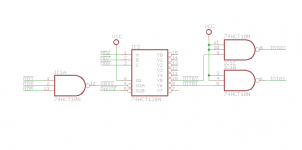

For the 314 I used different approaches like a 74HCT05 (connect the open collector or open drain outputs
together and pull them up) or a 74HCT32 in combination with a 7427. (Check the RX8E clone that I made)
Very often there are some not used ports which can be very useful to solve a problem like the nasty 314.
I started down that path, but the possibilities for 380 and 384 replacement mangled the layout enough that it seemed the routing would have to be totally different.
When I got to the 314, I was thinking to replace the IOT decoding with something like the attached, which replaces 4 chips with two, I think.
Of course, the more of that I do, the less it looks like the original PC8E.
Vince

Hey Vince. If you use a 74HCT238 you don't need to invert the outputs thus avoiding the sacrilege of using a 3 input nand as an inverter.
Probably true, but then I'd have wasted the 7410 gates, and would probably end up tying off the inputs anyway. There's also a pair of decoders breaking out the IOT operations later, and some trivial rework with a couple more 74138 in place of those eliminates the extra inversions.
More troubling to me was the departure from "re-implementing the PC8E with modern parts", moving toward "designing a PC8E work-alike". Feels like a slippery slope that leads back to the design where all the logic is just a single ATF1508. (I've got scripts to do the that, and more reliably than I can design stuff, already.)

Well, once I gave up on the routing problem (used the autorouter), making a "modern" PC8E board in the spirit of the old didn't turn out to be so bad.
Mainly I used 74HCT30 gates instead of the 314 gates, which meant I didn't need so many inverters. The other changes are more or less what Roland had suggested. I did switch to LS138 decoders, as those are much easier to find. Here's a PDF schematic if anyone cares :-):
http://svn.so-much-stuff.com/svn/trunk/Eagle/projects/DEC/Mxxx/M840/M840X.pdf
It may even be similar enough to the original design to "just work".
