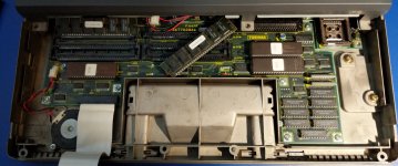

Well, perhaps this floating module might have something to do with it? :shock:
I notice that if I have the bit order backwards, the initial error code is:
1001 0100
Which would correspond to this POST message:
94h: 1st 64KB memory error
Which is a Halt error. That could make sense based on this floating module.
