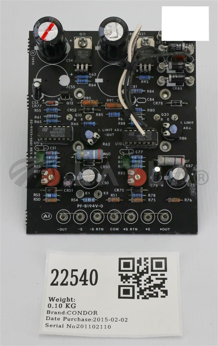

Well, this lot came from a massive collection of various electronic junque that's from the estate of a designer/engineer so there certainly could be missing pieces that were intended to be used with these boards. Really, the reason why I made this post is that I thought the main, large motherboard might be a board that someone would recognize, maybe some mail order SBC or something. Unfortunately the only marking on the pcb is "CONDOR".

Agree. It is very cool. I did notice "condor' but found nothing useful. It does not strike me as the typical Trainer, of which there are many. Given that you have duplicate sets, it does seem like these were for a specific, and maybe dedicated, purpose, but I don't know.
Well, I do believe that the engineer, from what little I was told about him, was someone who spent his life designing, researching and experimenting with electronics for a handful of different companies/organizations and apparently even held a patent or two for his designs, so yes, I would think that this is all just stuff that he designed and built/made by hand himself BUT it's the "CONDOR" and "COMPONENT SIDE" markings that made me think otherwise since it doesn't seem to make sense to me that he would bother putting something like that on the pcb, rather the pcb was manufactured but another company and he simply ordered abunch of them because the circuit did when he needed and it was easier to buy them then make them, plus the traces on motherboard and the accompanying memory boards straight and don't look hand etched, where as the two smaller boards are definitely hand etched as the traces are all curved, the boards are single sided, there is no markings made from etched material and they just look hand etched. I feel like the motherboards are actually some kind of general purpose computer and the reason why they don't have rom on the board is because they weren't designed for a particular purpose. We'll probably never know.....
The 4th board looks home-made to me. The Condor board could be a professionally manufactured board for sure. There could certainly be a mixture.
I see several Condor named companies relate to computers and PCB manufacturing to some extent, eg here and here. Have you done a deep search on the researcher/designer? It could give you some clues. One of the boards is marke as modified 2/09 so there could still be much in the archives available.
That's basically what I said and think, that the large motherboard and it's accompanying ram/memory cards are professionally manufactured and the two small boards are most definitely etched by hand. And yeah, I did search and saw companies with the name "Condor" but none that seemed like they had anything to do with the early days of microprocessing, the name is fairly generic which always makes searching a bit difficult
