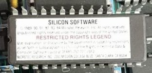

OK, jplr was so kind as to give this board to me, he mailed it to someone in France where my brother picked it up and brought it home. Somewhere in the middle it got delivered to the wrong address, someone picked it up in the street... all is well that ends well.
Some scans, as received -- the mail was not that kind to the RAM module.
So then I realised... this is not VME. P1 is I/O, from the MK68564 as well as from the four chips which are not fitted. P2 is the 68000 bus, buffered. VME has I/O on P2.
So I will have to buzz out the bus to figure out where to apply power etc.
I also dumped the EPROMs, found a few interesting strings.

The EPROMs have this sticker on the underside:
(Sorry, terrible photograph) Silicon Software (c) 1989, 90, 91, 92, 93, 94 Microtec Research Inc ... Santa Clara CA.
And that's all I know for now.

Oh I know what it is, it's weird I forgot. It's part of a system used at France Telecom operator to manage smart card payphones ("publiphones").
This card belongs to a SGTD (système de gestion technique décentralisé), it was a VME system having a 10 or 20 Mbytes hard disk. It ran OS-9. It called another more decentralised unit called URP ("unité de raccordement de publiphones") with V22 modems. URPs were 68K systems without hard disk that managed smart card payphones.
The SGTD was made by Crouset in Valence (France). URPs were made either by Crouset or Dassault. Payphones were made by Crouset or Schlumberger. The payphones used NSC800 microprocessors.
