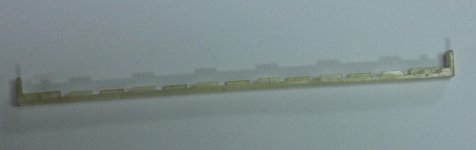

I recently got this YE Data YD-380. I was trying to make it work with 360K disks. I tried to find documentation about the jumpers but couldn't, except this service manual that was of little help http://electrickery.hosting.philpem.me.uk/comp/divcomp/doc/YE_Data_YD-380_5.25inchHHHDFloppy.pdf
So I started messing with them, but couldn't get it to work.
I was closing it back, after cleaning it a little, but I found this plastic thing, I don't know where it goes. Can anybody of you please tell me?
Thank you
IIRC, the YD-380 is one of the weird high density floppy drives that will not read double density disks. Pin 2 which normally does the density select isn't connected on the YD-380.
Could you provide the dimensions of the plastic thing? Helps to figure out where it can't go. I would suspect that it is a guide rail for the read write head; if it is, you should see a matching guide on the other side of the read write head. I don't have a YE Data drive to disassemble and confirm that guess. So I could be completely wrong.

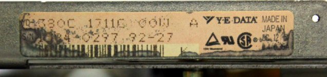

You mean this isn't a YD-380?
Model:
YD-380C 1711C

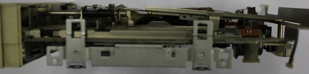

Drive and thing size, for reference:

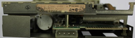

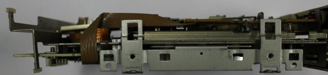

Some info I can read:
PCB:
PN138 500-01 REV C 1 D
FD884
KUMAGAYA
ICs:
YE DATA
MB87633
9208 Z37
BA6589K
213 107
LB1656
2B4
M56733APP
215000
JUMPERS:
I can read DS0, which also appears in the maintenance manual. I think it refers to the first pin pair. Then, I think it says M2 and M1 and I can't make out what these jumpers are for.

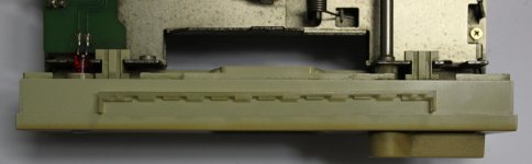

I just found out.
Now that we know this, you can tell me what are the differences with your YD-380 unit, and if you know, the jumper settings.

Got curious. The only information I can find about 380C is at http://zx-pk.ru/threads/10863-podklyuchenie-diskovoda-5-25-ye-data-yd-380c/page2.html a Russian language Sinclair fan forum. It looks to have pictures which if the model is correctly identified might help identify what should be on the drive. If the topic is correctly translated, the thread is about modifying 380C. Automatic translation mangles technical details.
As far as I can understand (limited Russian knowledge) one user there managed to get it working as a 720k QD drive, says he tried all possible jumper combinations and then reading the datasheet he modified two cables from the motor flex to get it running at 360 - 300 rpm. It involves the first and second cables, I think he grounded them, not sure. I think it would be harder to make it work as a 360k drive.
Great find krebizfan.
So according to what other users say, this model is the YD-380C, late model (early 1990s) 1,2 MB only (720k capable with this mod).
