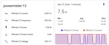

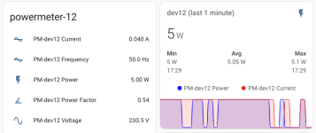

an this is the consumption
The image on the monitor screen is vitually identical to before.
I can't see a reason to not use this.
Also ,the standalone consumption of the smps is 0 watts compared to 2.4W of euro 1400.
I hope this would be beneficial to someone.

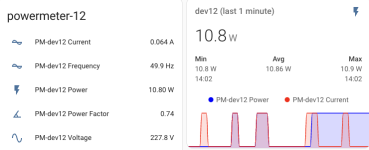

If you are just thinking of just using the step down buck converter regulator in place of the 7805 with the original sinclair power supply (euro 1400 in my case);
this is the consumption of the original setup with 7805 and euro1400
and this is the consumption of euro 1400 with buck converter regulator
It seems that the 7805 alone wastes about 3.2 Watts of unnecessary power as heat into the system.
Considering that the total consumption becomes 5 Watts with SMPS and Buck regulator,
disregarding the smps inefficiencies. we can safely say thay 7805 alone wastes more than half of the total system concumption,
which is actually about 65%.
It is almost a crime not to get rid of the 7805.
