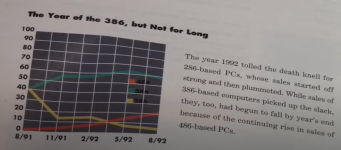

Like many things the 286 was at its best, most numerous and cheapest near the very end 1991/1992.According to PC/Computing magazine, 286 and 386 sales were tied at 40% each in August 1991. By February 1992, 386 had around 55% of the market while the 286 was down to about 15%. By August 1992, it was 60% 386, 20% 486, and 5% 286.

Would the Am386 hitting around that time have played a big role?Sorry for the bad angle, but 386s didn't overtake 286s in sales until late 1991.
