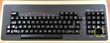

The VT102 is fully cleaned up now (photos) and seems to be working fine except for the CRT geometry.
I didn't notice it until I had a wall of text scrolling by but the text is larger at the top of the screen and the vertical size is short.
I'll look for a service guide for it and see if I can adjust it.
Just open it. There are several potentiometers you can adjust, and they are marked on the board what they are for. And one is for that exact thing.
Looks like you got one in good condition; I didn't notice any yellowing at all.
Oh, there's yellowing but it's not even all over. Also, I did so much scrubbing with a magic eraser to get it cleaned up that I removed some of the yellowing just by removing some of the surface.
(photos)
BTW, did you have a spare period key for the numpad I could buy off ya? I sent you a PM.
