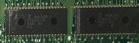

What resolution and color depth are you using? Get a good camera in a lit room and take a picture of the motherboard where the Tseng chip is AND the surrounding video memory so we can tell if you have 1MB or 2MB of video RAM.

I got those pictures too, one is a general picture of the area, and another is a close up of what I think are the chips, being they are right next to the actual tseng chip.

The intergrated video on this system should be local bus, which would make it quite a bit faster than any ISA card you could get for the system. The ET4000/32i should support 16.7 million colours at 640x480 and 64k colours at 800x600 with 1MB DRAM which is what you probably have installed. This is assuming of course that the RAMDAC for the card can handle it, but you haven't yet provided a picture of that. From what I recall 1024x768 graphics modes on this card might be interlaced, so you might want to avoid those.
What kind of VGA Wonder do you have in there now? There were quite a few variants, and the last two supported high (VGA Wonder XL) or true colour modes (VGA Wonder XL24) in 640x480 and 800x600. With 1MB, those should also support 256 colours at 1024x768 non-interlaced, but at a fairly low refresh rate.
