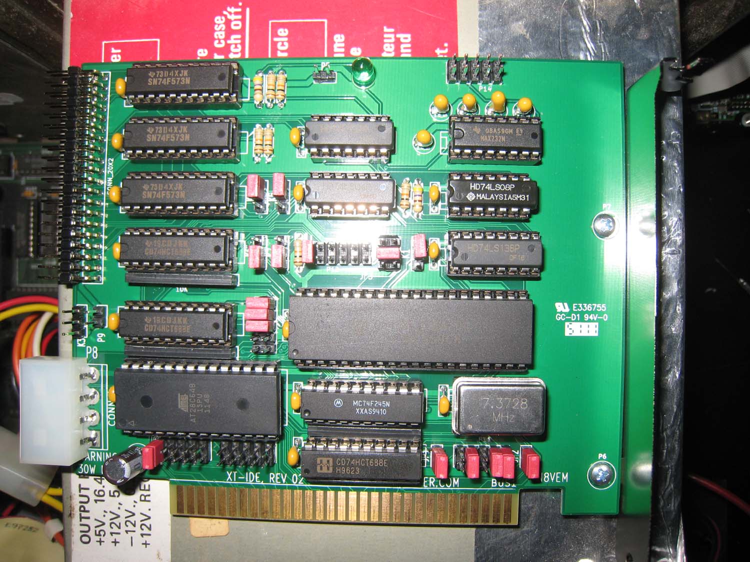

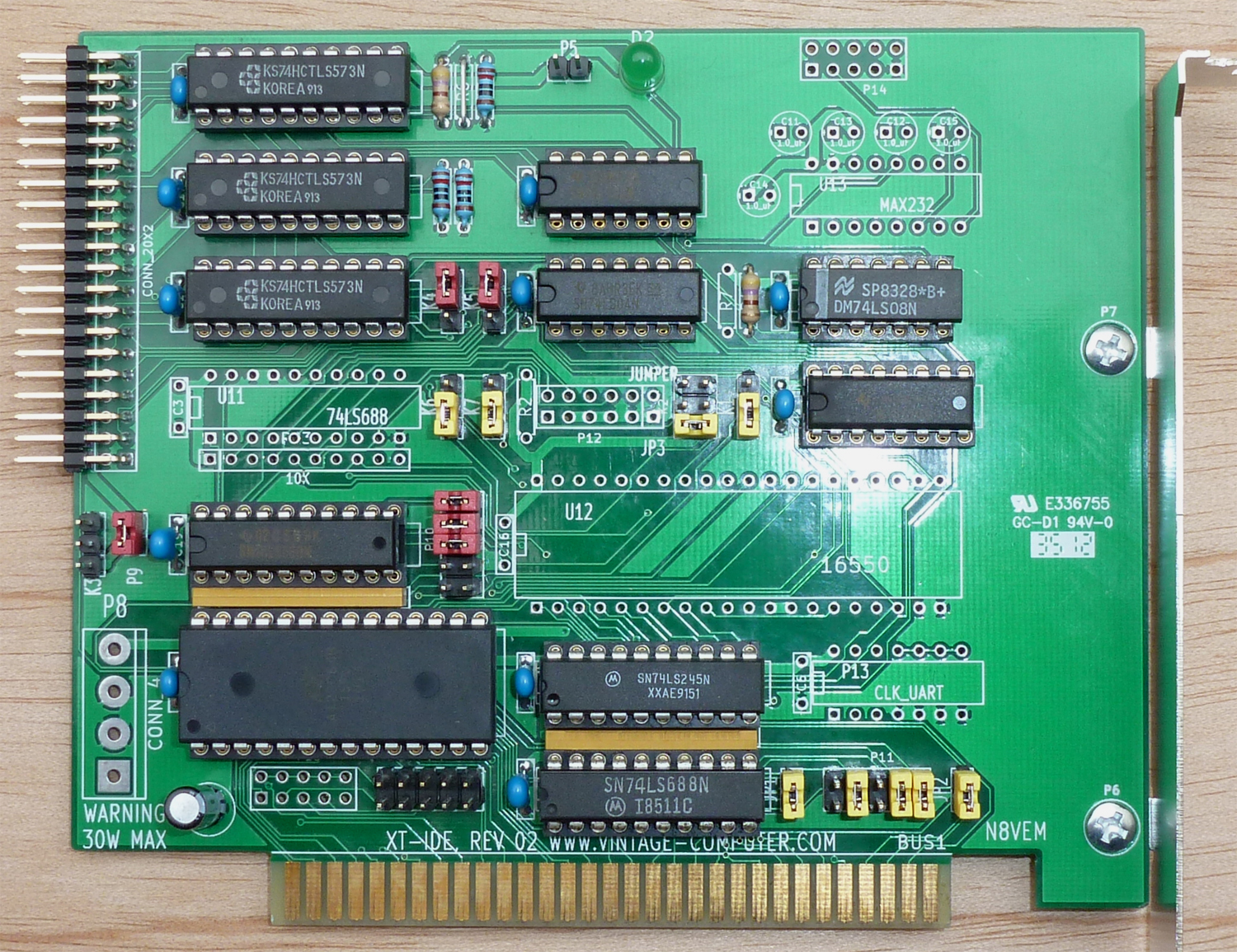

[h="2"] High resolution photos [/h]
Photo #1 ( Note: 28C64 ROM in use - jumpers K2 and K1 are incorrectly set for that. )
Photo #2 ( Note: Optional UART circuitry not fitted. )

P9 near the IDE connector is a power enable/disable jumper to pin 20 (Vcc) If you are using a DOM or other low power device that can accept 5 volts on pin 20 to power the device itself, put a jumper on P9. Then you won't need an external power cable.
[h="2"] Resistor R6 [/h]
A design error in the XT-IDE revision 1 card, which carried through to the revision 2 card, concerns the 'cable select' functionality (CS) of the IDE specification.
Discussion of this design error in the XT-IDE appears in the XT-IDE thread starting [here].
For a lot of XT-IDE users, that won't be a problem, because the IDE device in use will probably be set to 'master', not CS.
If the IDE device that you attach to the XT-IDE does not have master/slave/CS jumpers, then it is possibly using CS.
Note that a lot of IDE-to-CF adapters have master/slave jumpers.
Should you wish to correct the design error, replace R6 with a wire link (photo), or bridge the ends of R6 using a piece of wire.

[h="2"] Assembly notes [/h]
Some notes for building the card:
* SIP resistors are mounted with the printing facing down, toward the ISA connector.
* The 14 decoupling caps are not polarity sensitive.
* The 5 caps around the 232 driver IC are polarized. Note the + mark on the PCB must match the + on the cap.
* The single large cap is also polarized.
* The LED is polarized. It has one side flattened to indicate polarity. Match the flattened side of the LED with the PCB silkscreen.
* Pin 1 for the IDE connector is down, closest to the ISA connector.
* Pin 1 for the 9 pin serial header is on the left side (look for the square hole on the back of the PCB).

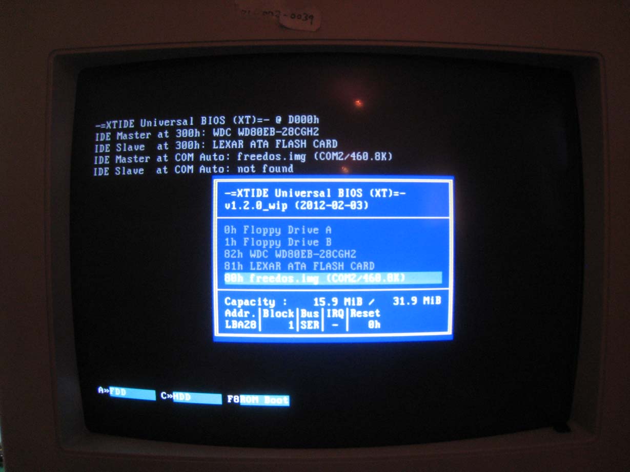

[h="2"] Booting via UART [/h]
Supporting software, serdrive.exe and FreeDOS.img, is here.
Click here for instructions.
Where in those instructions it specifies "SerDrive ImageFile.img", you will use "SerDrive FreeDOS.img".
Note that IMG drives show up as normal drive letters in DOS. So you have the option of booting to a local drive and then accessing the serial drive as D: or E:.
