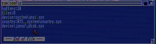

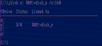

SideCar's Boot screen
Details of last tests
DOS3.30 boot and ATIME getting Amiga's date
JLINK virtual disk
ARead / AWrite tests
04_AReadScreen.png 05_StartupSequenceScreen.jpg 06_AWriteScreen.png 07_RamConfigScreen.jpg
DJMount / Write to HD2: test
ADisk - Anomaly [no idea why, may be this partition was incorrectly created before last build] on number of cylinders (deleted and recreated the partition => fixed)
Folklore (worked after a reboot/second attempt - My A1000 isn't very stable)
Regards - Hervé
